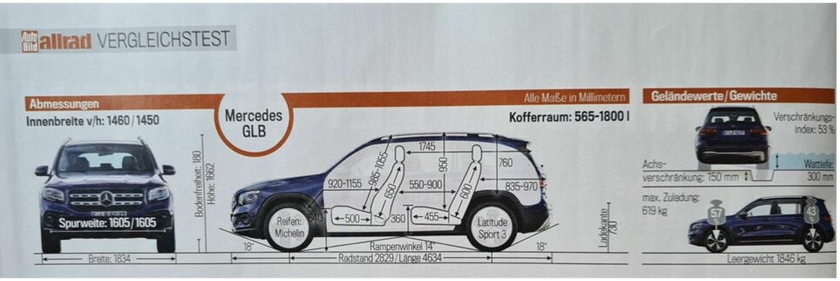

Anyone kind enough to let me know the height of the trunk opening? I searched the GLB threads but could not find any topic on this.
I'm shopping for new car, GLB is on my list but the car must fit my Mountain Bike (Need 32+ inch height) inside the trunk, don't want an exterior bike rack.

It is around 76cm ~30"

Thank you, from the video it show roughly 30", that mean it'll fit since the spare wheel cover can be set to lower position, it should be around 34" at lower position.

Yes, you can lower the trunk floor cover if that is all you need. The seats will be higher compared to lowered trunk.

The trunk opening is 42.5" w by 32" H. Lower floor setting to the lowest part of the roof liner is about 34", and it gets to approximately 36" about 12" further in, as the roof liner gets taller.
