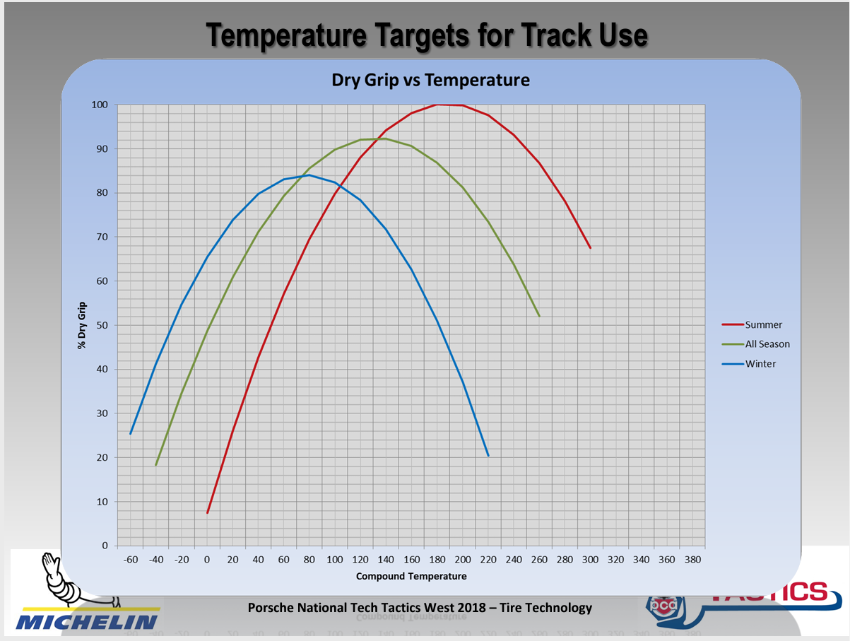

I don't know where you are located, but if you are not running the summer tires at high temps, they might be bouncy also... Here is graph from Michelin that shows the grip vs temp:
