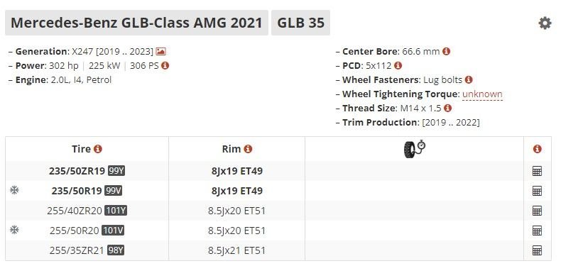

GLB 35 brakes are larger than on GLB 250 so verify an 18" wheel diameter is large enough. Also verify the bore size will be compatible. 19" OEM wheels for a GLB 35 per Wheel-Size.com are 8" wide, offset 49mm (8Jx19 ET49) with 66.6mm bore and come with 235/50ZR19 tires. The Rim & Tire Size Calculator https://www.wheel-size.com/calc/ is very handy, but it doesn't account for brake size variance.

Here is the wheel sizes for GLB 35:
https://www.wheel-size.com/size/merc...lass-amg/2021/
You need at least 19" wheels for the front brakes... Also you need wheel spacers for ET 54... You can also look for MB winter packages or aftermarket wheels with winter wheels from companies like tirerack, etc.
