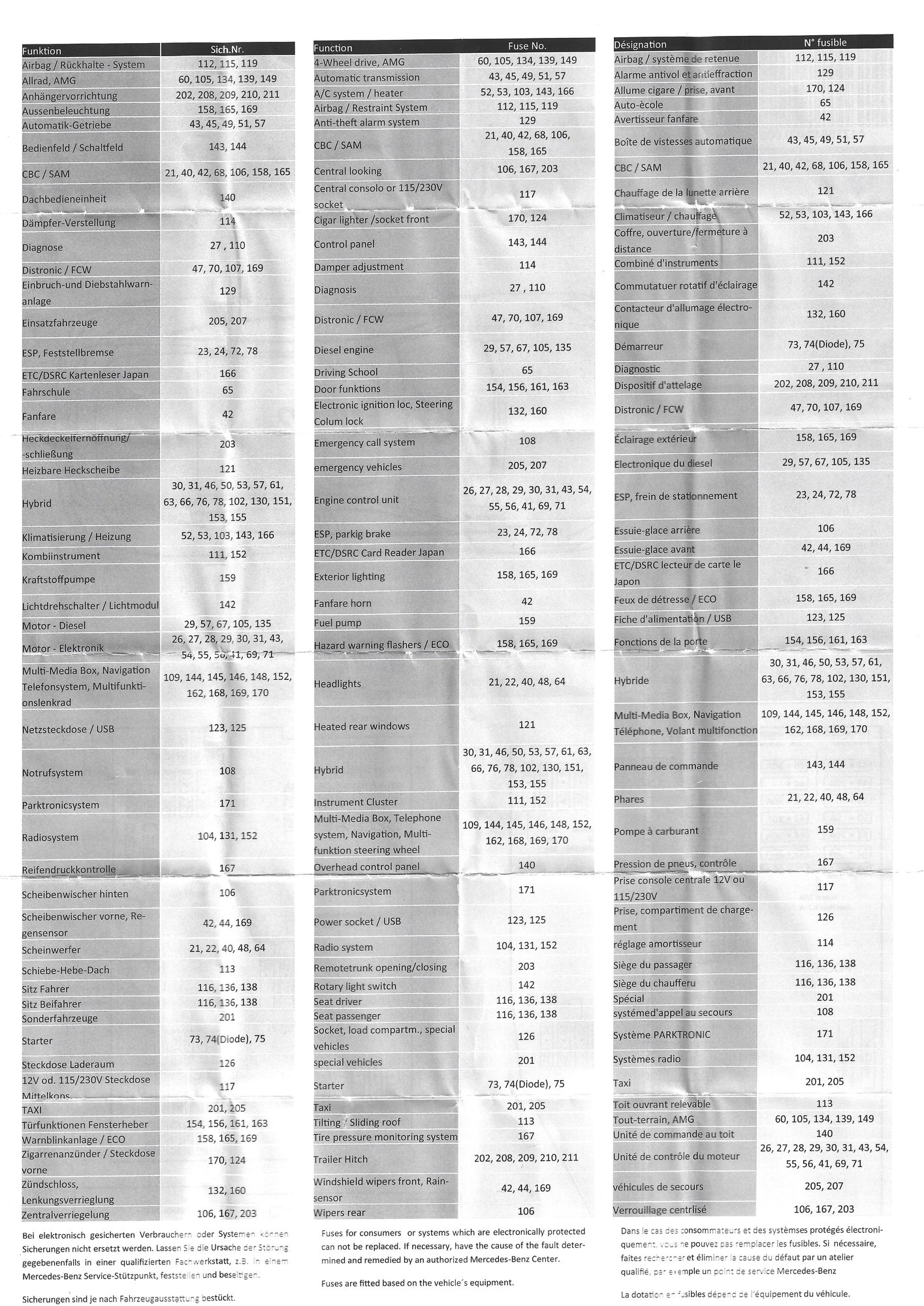

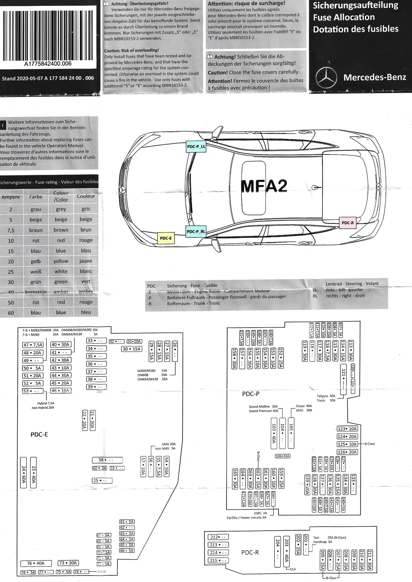

For GLB 200D 2023 used location 125 to install hardwired nextbase dashcam to work with the switch, the fuse diagram for this vehicle is folded inside the fuse box in the engine compartment.
Mercedes Benz GLB 200D Fuse Location
Mercedes Benz GLB 200D Fuse Allocation
