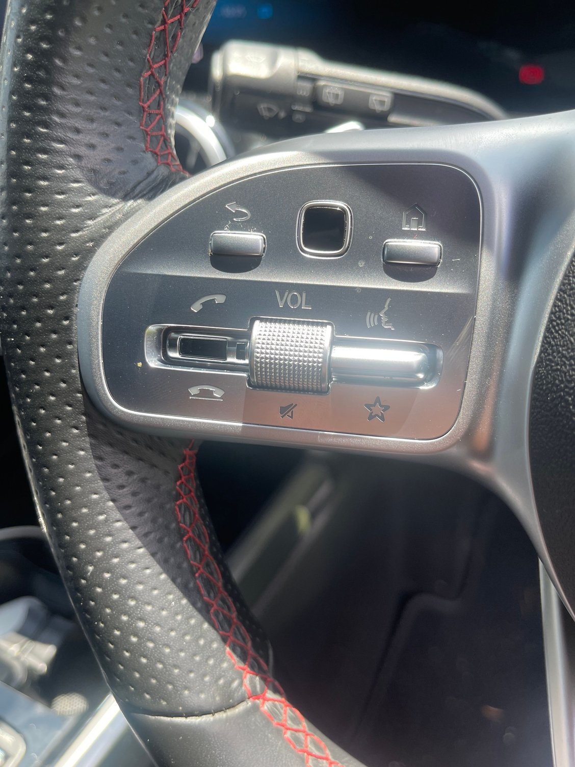

Hi All,
The Call Button on the steering wheel has snapped off. It looks like the plastic stem has broken.
Does anyone know if there is an easy fix/replacement?
Thanks

If you are out of warranty you need to replace the entire switch module. You can buy a pair on eBay for about $100. You might find just the one you need instead of 2.
There is a YouTube video on how to change it. The airbag has to come out, but it does not look very complicated.
