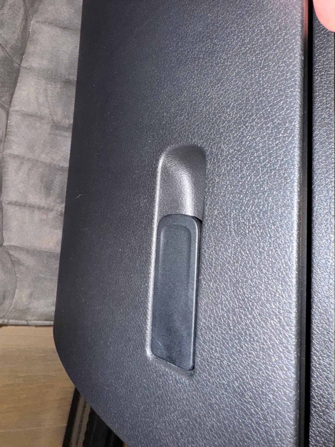

The glove box release mechanism stuck. And it happened when I urgently needed to open the glovebox of course.

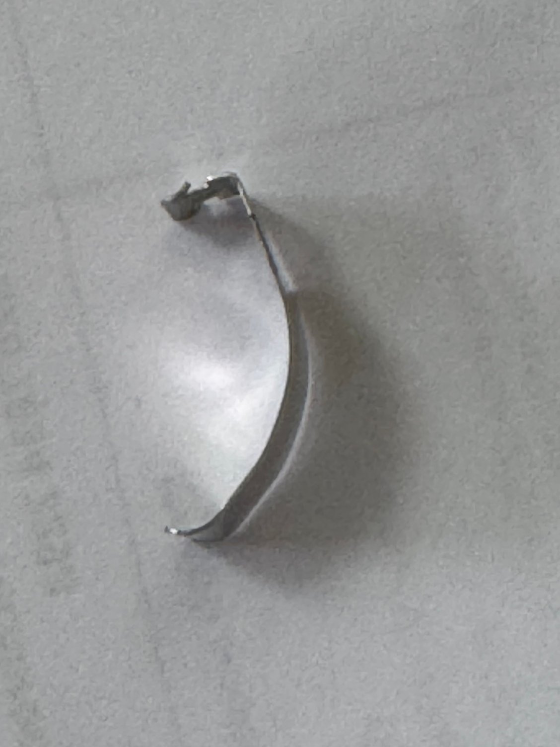

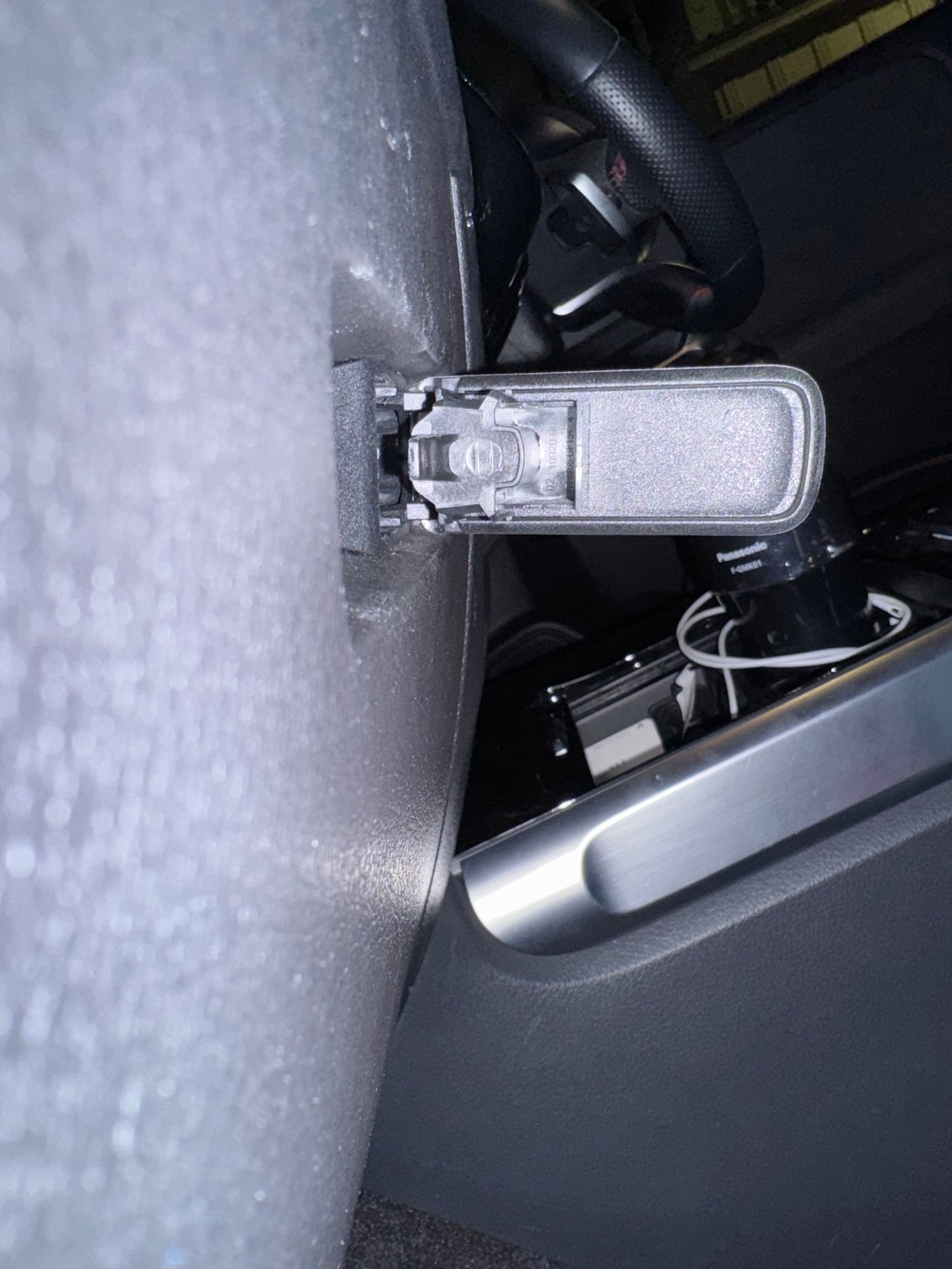

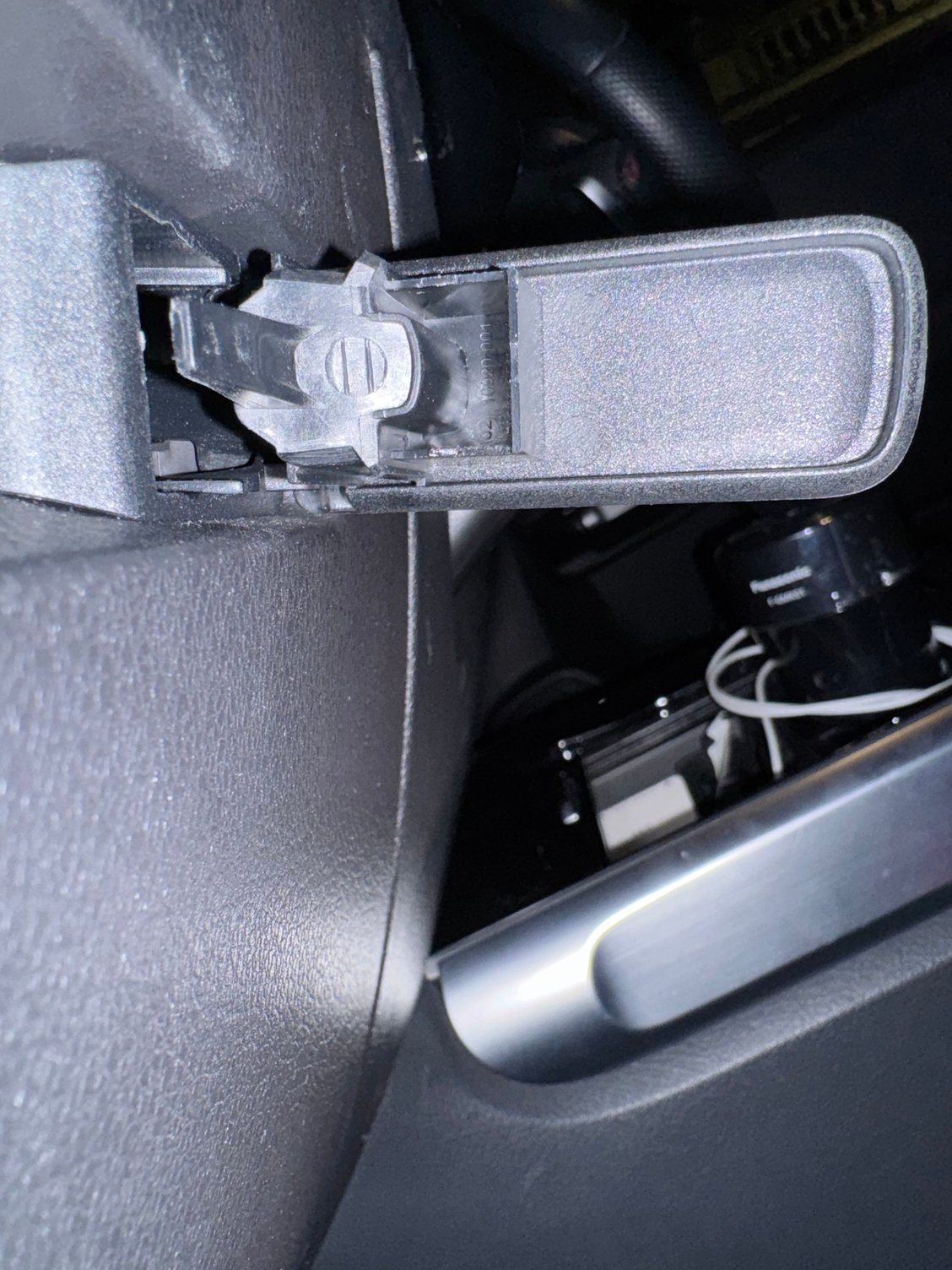

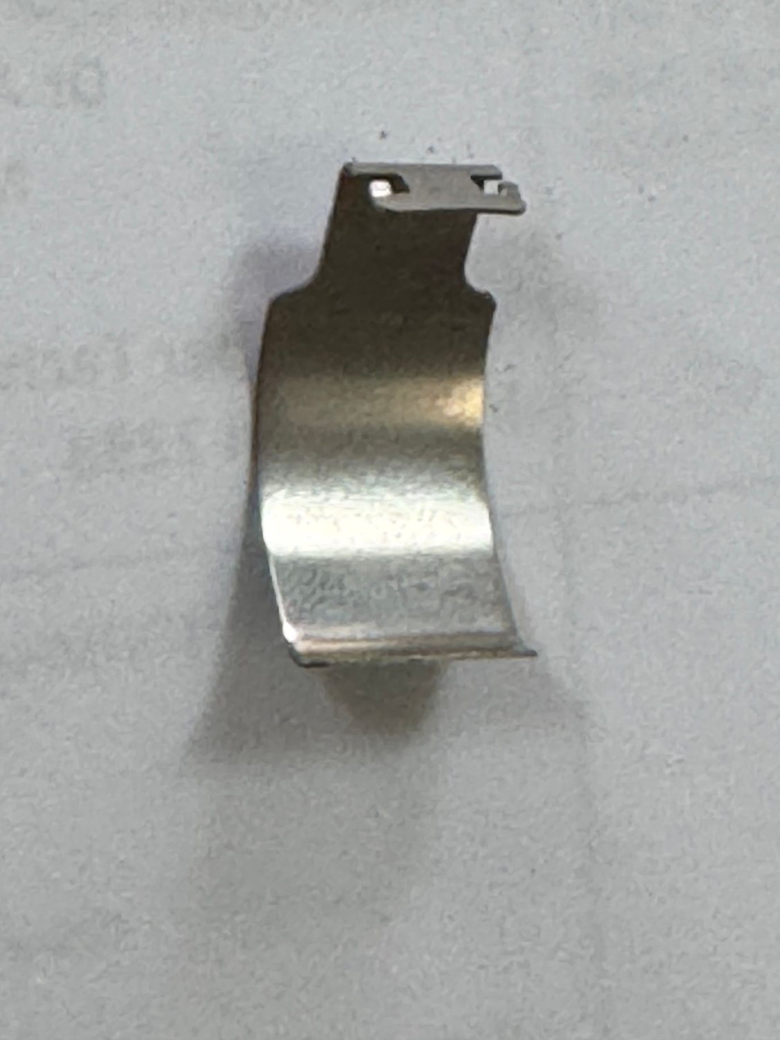

So I pulled the handle hard and it came out and the spring popped out - please see photos.
Nothings was broken. Now my question is really how to assemble it. Any ideas please?

I dismantled the whole glove box first.
there are three screw inside, two underneath and one on the side. Easy.
The metal spring above goes between the door handle and the pin which is used to fix the handle.

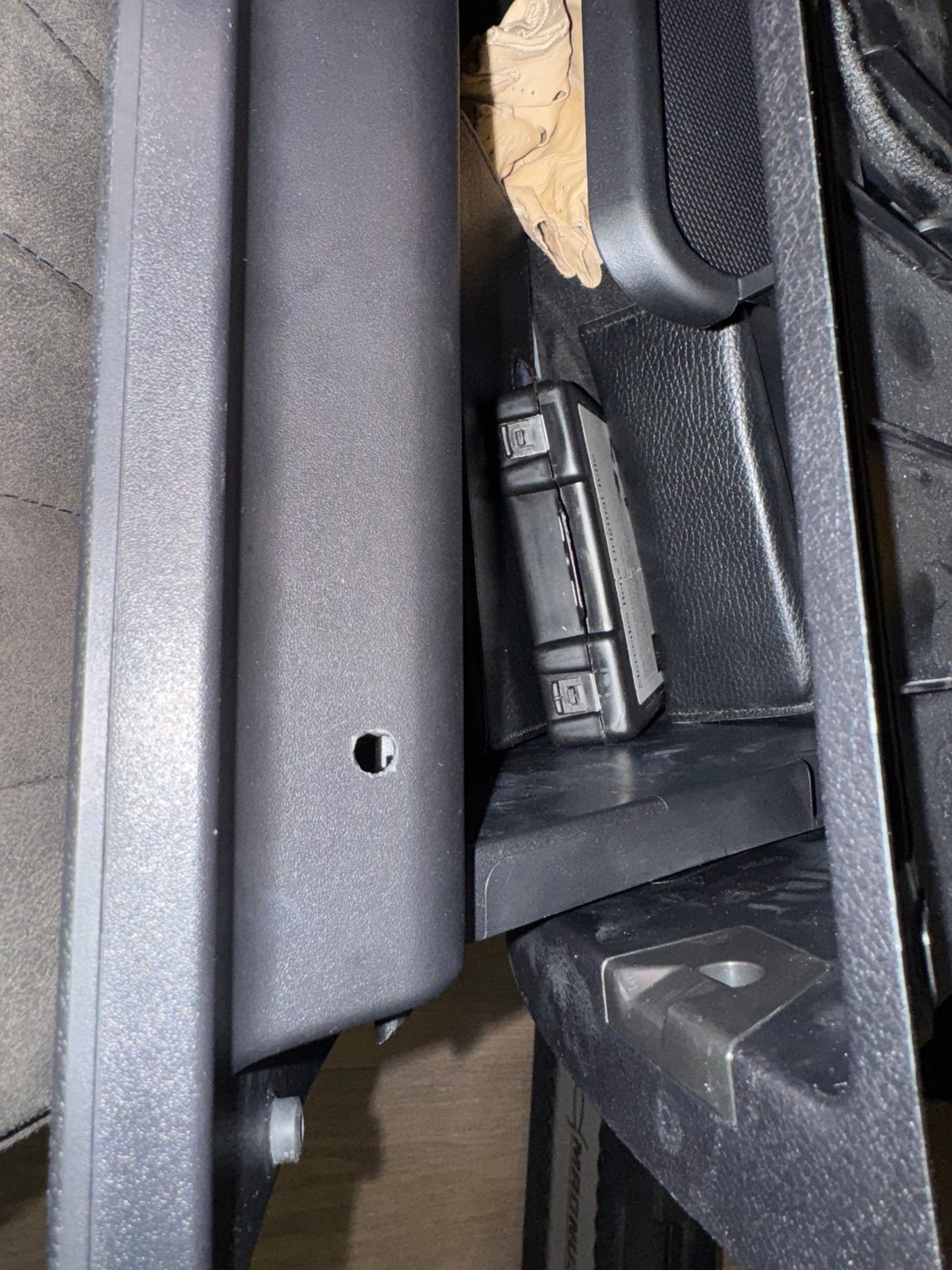

I had to drill a small hole in order to facilitate pulling the lever through I have used same as internal colour glue to close the hole then.
