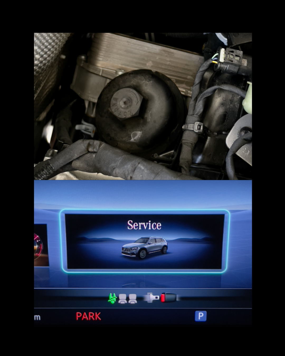

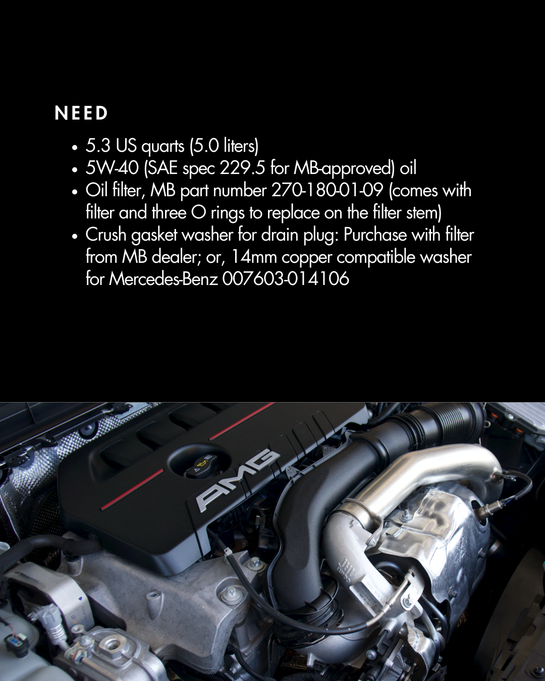

For my 2024 (manufactured in Feb 2024) AMG GLB 35 4MATIC, here's what I found for oil change info. Anyone who's here in the forums is super cool and smart to figure out how to do most of this (and honestly, this was the easiest oil change in a vehicle I've ever done). But, I'm posting this info as I found so many different specs, sizes, weights, tools, etc. for the car online that I wanted to let you know what I used on my vehicle per my dealers instructions for this year and spec. (The images have info on them and were actually used in an Instagram post; sharing here.)
—5.3 US quarts (5.0 liters)—5W-40 (SAE spec 229.5 for MB-approved oil). Of course, use the recommended oil type for your area/climate. I'm in Arizona so it requires Hell-prevention levels of viscosity.
—MB oil filter part number: 270-180-01-09 (this will come with the filter and three differently-sized O rings to replace on the filter stem)
—Crush gasket washer for drain plug: Purchase with filter from MB dealer, or get 14mm copper compatible for Mercedes-Benz 007603-014106
Tools Needed:
—27 mm socket and extension for oil filter housing. (As shown on the housing cap, reinstall at 25 + 5; so, no more than 30 ft Nm.)
—13 mm socket for front floor tray; remove 8 bolts
—12 mm socket for oil drain plug
You can replace the filter before or after draining the old oil; I found it easier to replace the filter right before you put in the new oil, as the car will most-likely be back on the ground/off the jacks or lift and easier to get to.
If changing the oil between the required factory intervals, do not reset the computer — only reset it when you are changing the oil at the required factory intervals (10k for the 2024 AMG GLB 35)

Very nice visuals, thanks for your contribution OP.

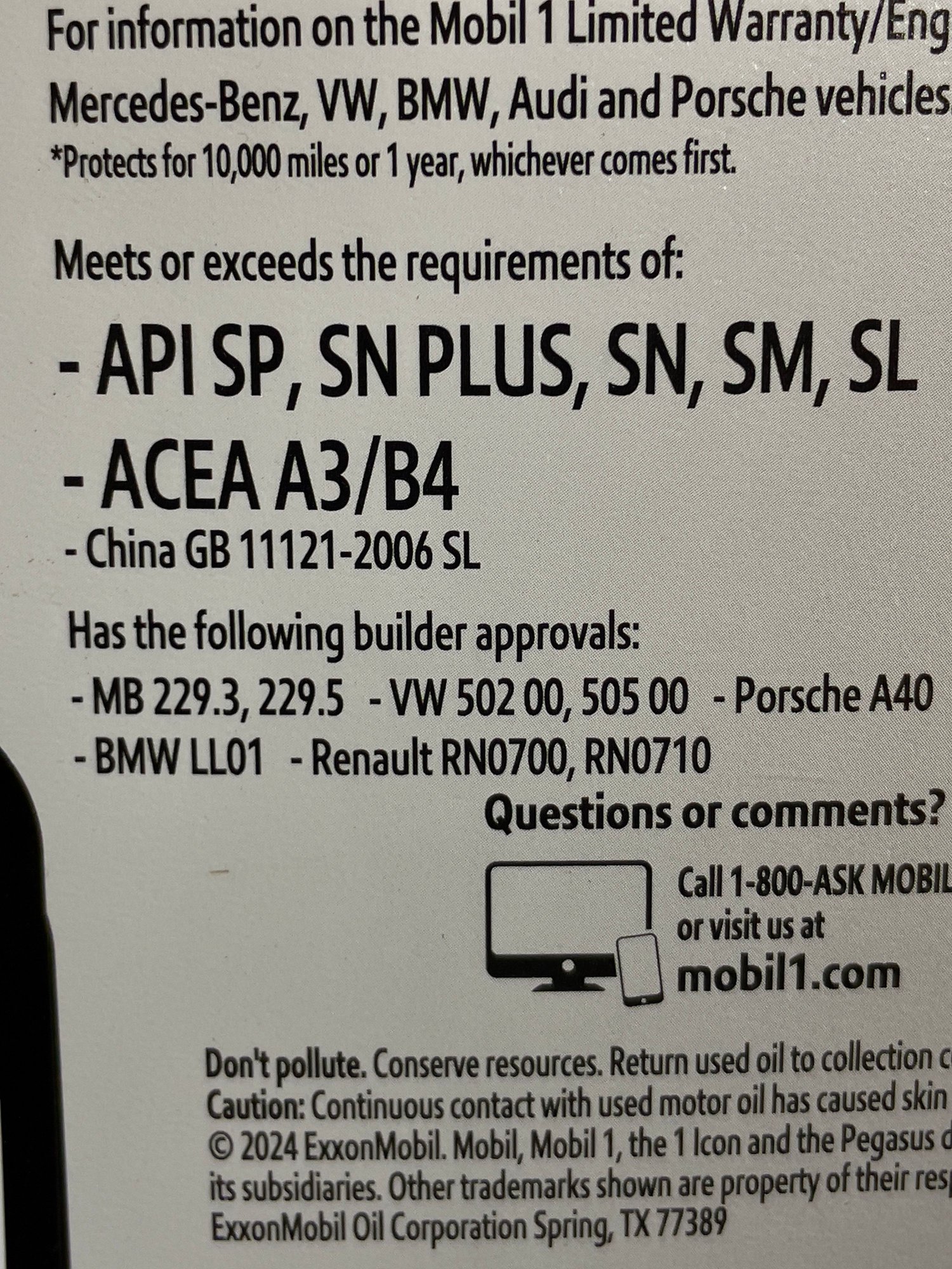

Question for anyone following this thread - I'm seeing a capacity of 5.8 quarts with filter; is 5.3 quarts the more accurate number?
As far as oil, Castrol seems to be the only one I can find that states it's 229.5 Approved:
Amazon.com: Castrol Edge Euro 5W-30 A3/B4 European Advanced Full Synthetic Motor Oil, 5 Quarts : Automotive Amazon.com: Castrol Edge Euro 5W-30 A3/B4 European Advanced Full Synthetic Motor Oil, 5 Quarts : Automotive
Mobil 1 has a Euro line but the numbers on the back read as MB 229.31, 229.51 & 229.52 - would these be similar to the MB 229.5?
Mobil 1 ESP Diesel Full Synthetic Engine Oil 0W-30 5 Quart
Granted, I did find one on Amazon that list as 229.5:
Amazon.com: Mobil 1 FS European Car Formula Full Synthetic Motor Oil 0W-40, 5 Quart : Automotive Amazon.com: Mobil 1 FS European Car Formula Full Synthetic Motor Oil 0W-40, 5 Quart : Automotive
Or is OEM the way to go? Any better deals out there?

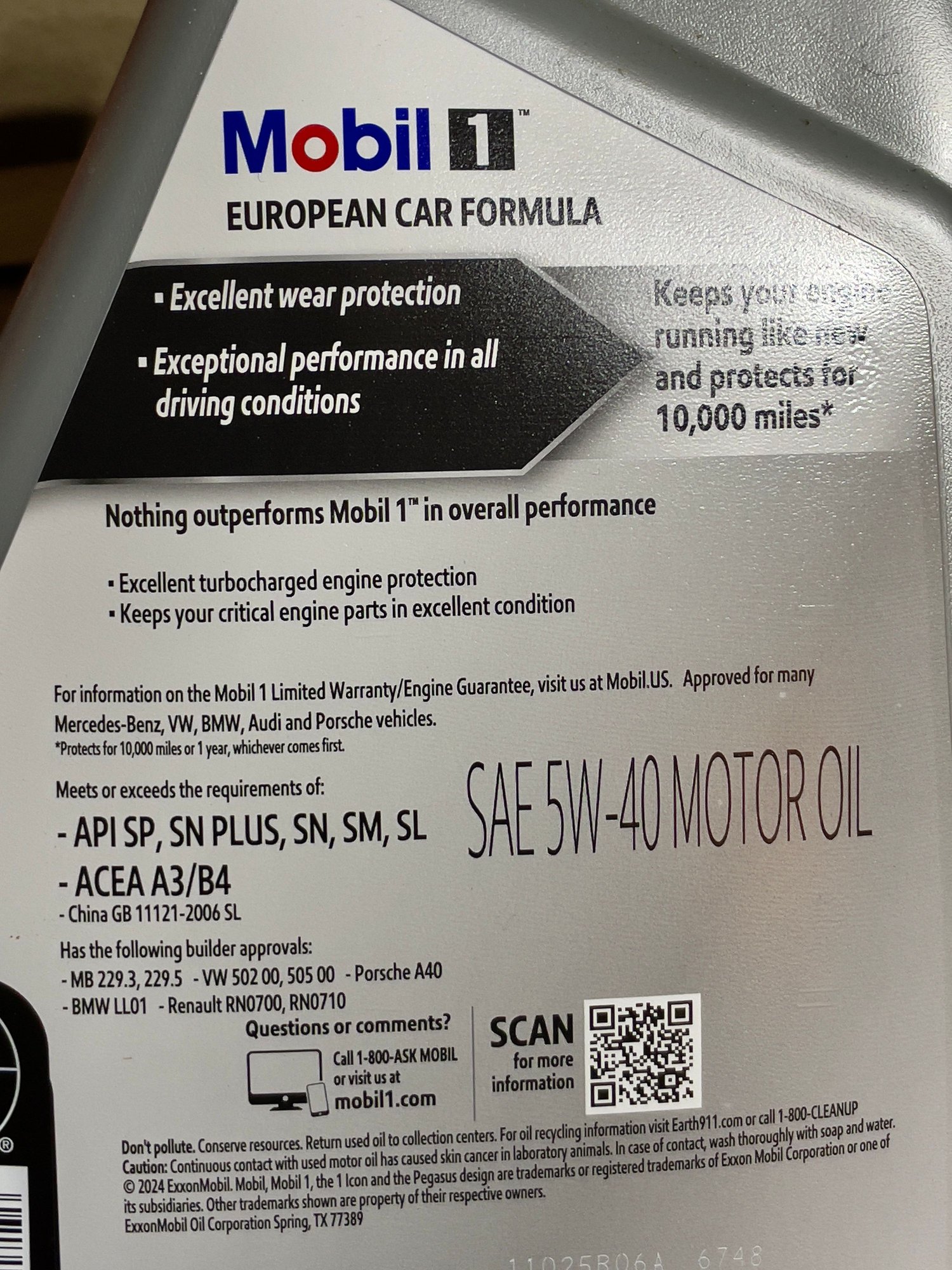

Hey, Serge. The 5.3 vs 5.8 question: Maybe? My dealer and my printed user guide say to use 5.3 quarts and so far it's still showing at max level in the computer (oil change about four weeks ago as of this writing).
I used the 5W-40 "as the dealer said so" (noting the online issues I found when researching, above) and have always used Mobil-1. Plus, in this case, Mobil-1 stated on the back that it was for MB and 229.5, so I went with it.
If you prefer another oil brand, that's all good -- I'm just unsure of the other 229.5__ approved numbers. I did see that some were newer formulas, less ash, more slippery, and other things I didn't understand. And since Mobil-1 said it had Mercedes-Benz builder approval, I went with just the .5. Not sure again if any of this helps. I also found mine at local Walmart.
(PS: OEM can always be the way to go, but then it's gonna be more expensive for the same thing, of course -- I also saw your Genuine Mercedes Engine Oil on Amazon but chose not to get it at that price. Mobil and Fuchs are suspected to make MB OEM oil, so as long as any brand is within spec, it's good.)
