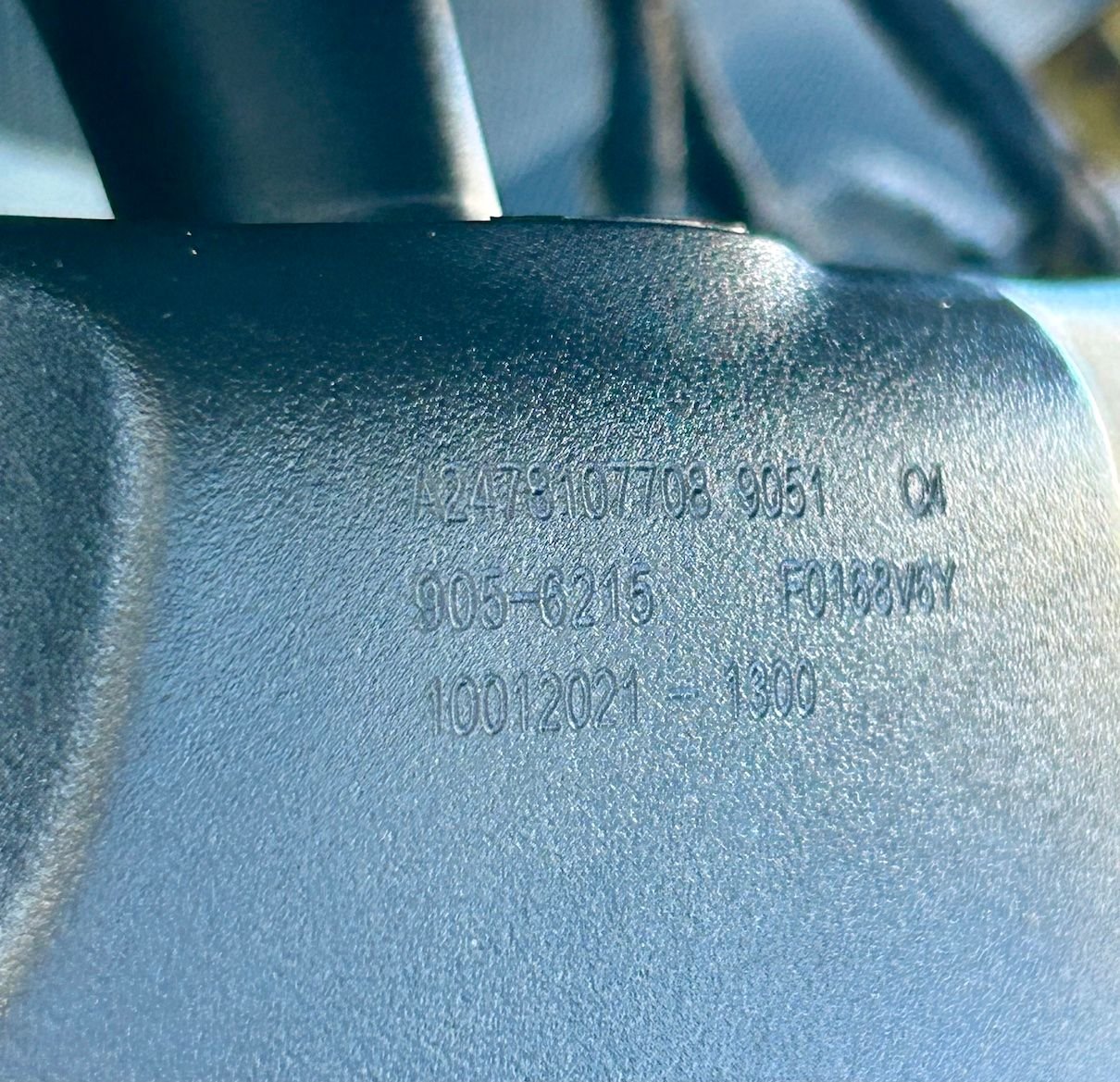

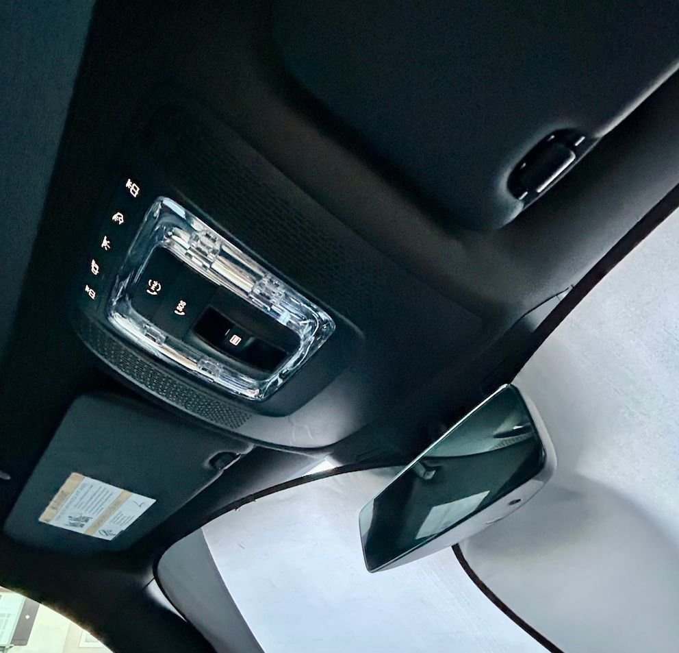

Thanks guys (or gals)... So I started researching how to get a mirror with the HomeLink buttons retrofitted. First thing was to figure out what mirror part number I have:
Mirror is Auto-Dimming with Map Lights
Mirror is Auto-Dimming with Map Lights, NO HomeLink!
Mirror Part Number = A2478107708

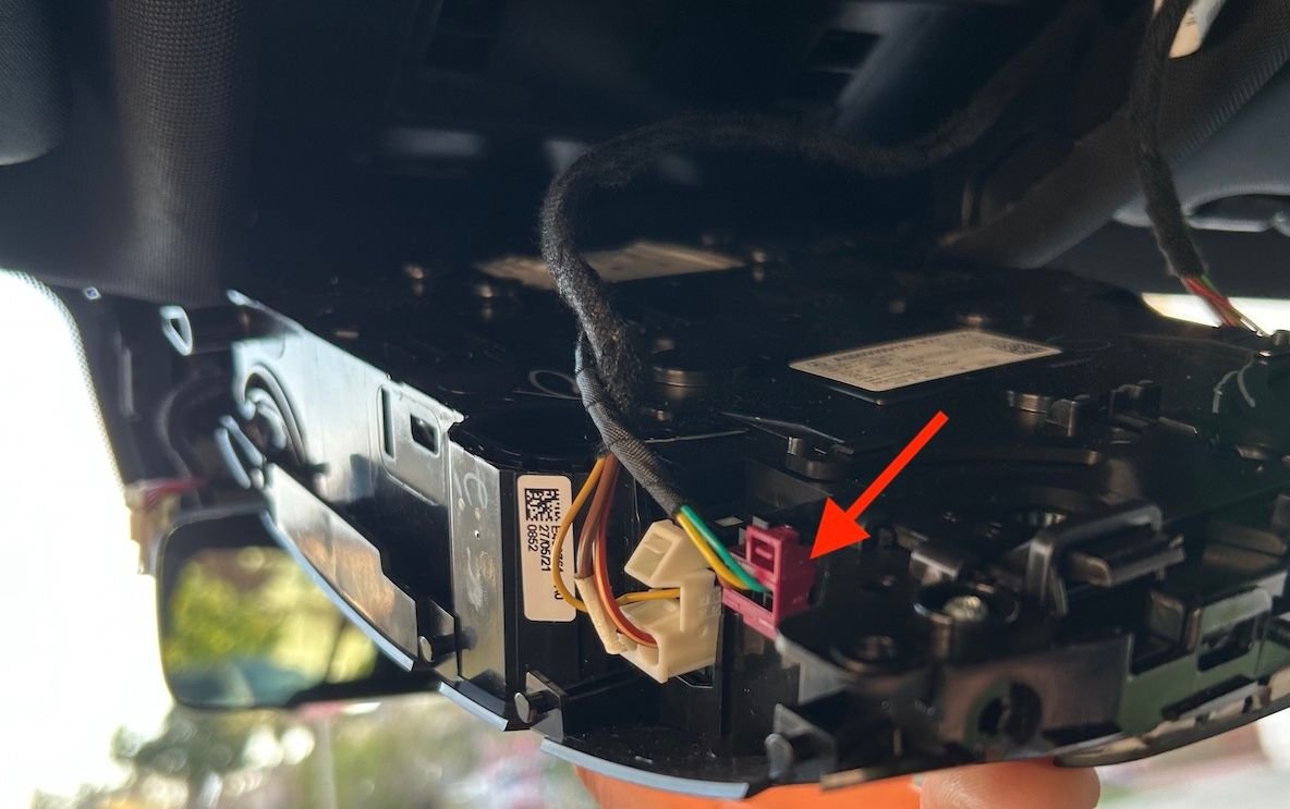

I also noticed that some had a short blue connector near the mirror arm and some had a longer wire with a purple connector. Decided to investigate and found that my car uses the longer wire with purple connector:
Placed the order for the mirror and just waiting for it to arrive! Hopefully it is plug and play but might need some coding help from @BenzNinja

FYI and thanks to the original poster. I went with the purple plug and it's a simple install and plug and play. Works like a charm. But watch how much pressure you put on it when installing it. I cracked my windshield. So this simple mod came out to be a little costly.
