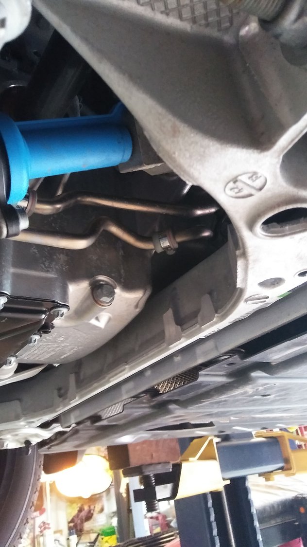

Nice work up thanks... ???? was there much oil left in the filter housing when you pulled out the filter?
Old Mar 19, 2020 | 10:49 AM
linus69's Avatar
Veteran: Navy
Joined: Mar 2019
Posts: 103
Likes: 28
From: NE PA
2019 GLC 300 4Matic SUV
As I had learned from utube the MB filter is designed to drain off into the engine, so before lifting the car I removed the engine oil fill cap and loosened the oil filter lifting it slightly and leaving it slightly cocked in it`s housing. I then lifted the car and removed the oil pan plug and let it sit for a couple of hrs to drip out, the dirtiest oil comes out last. The amount of oil left in the filter-housing is shown in one of the pics, it was not very much and I just wiped it out with paper towels before reinstalling the new filter in place.
