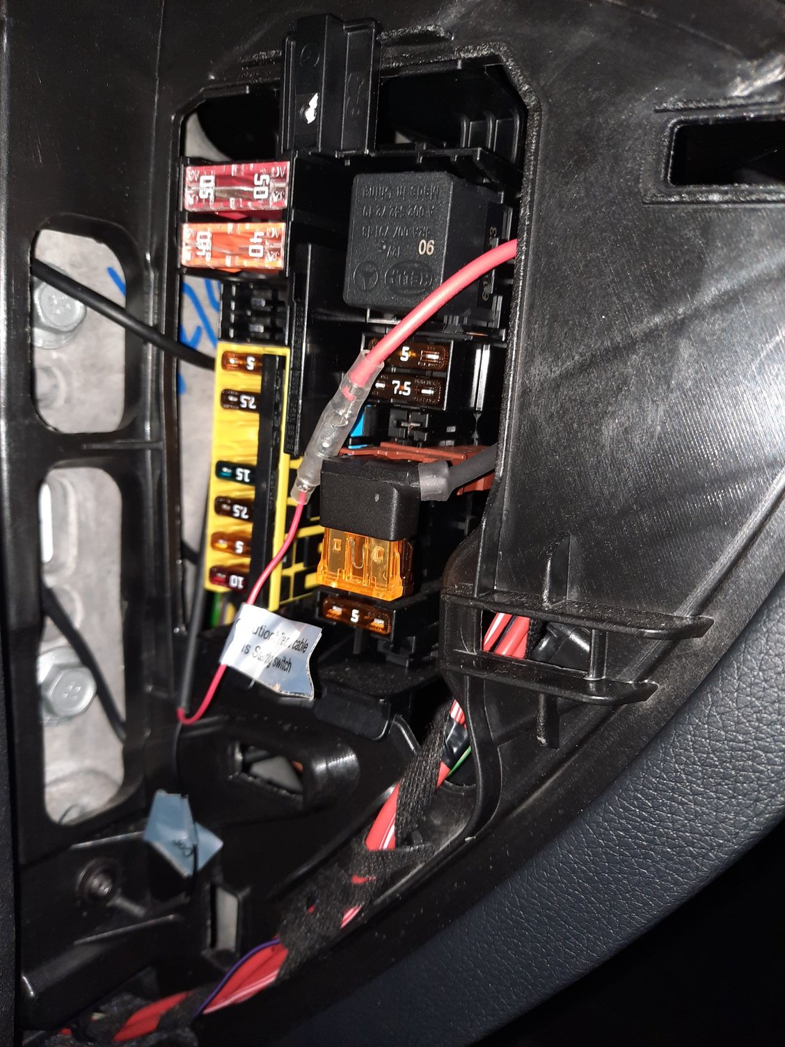

Left side fuse have many ignition+.
I used one for a dash cam.
Probably also constant+.
Check it with a multimeter.
There's MB fuse diagram at your trunk fuse box.
