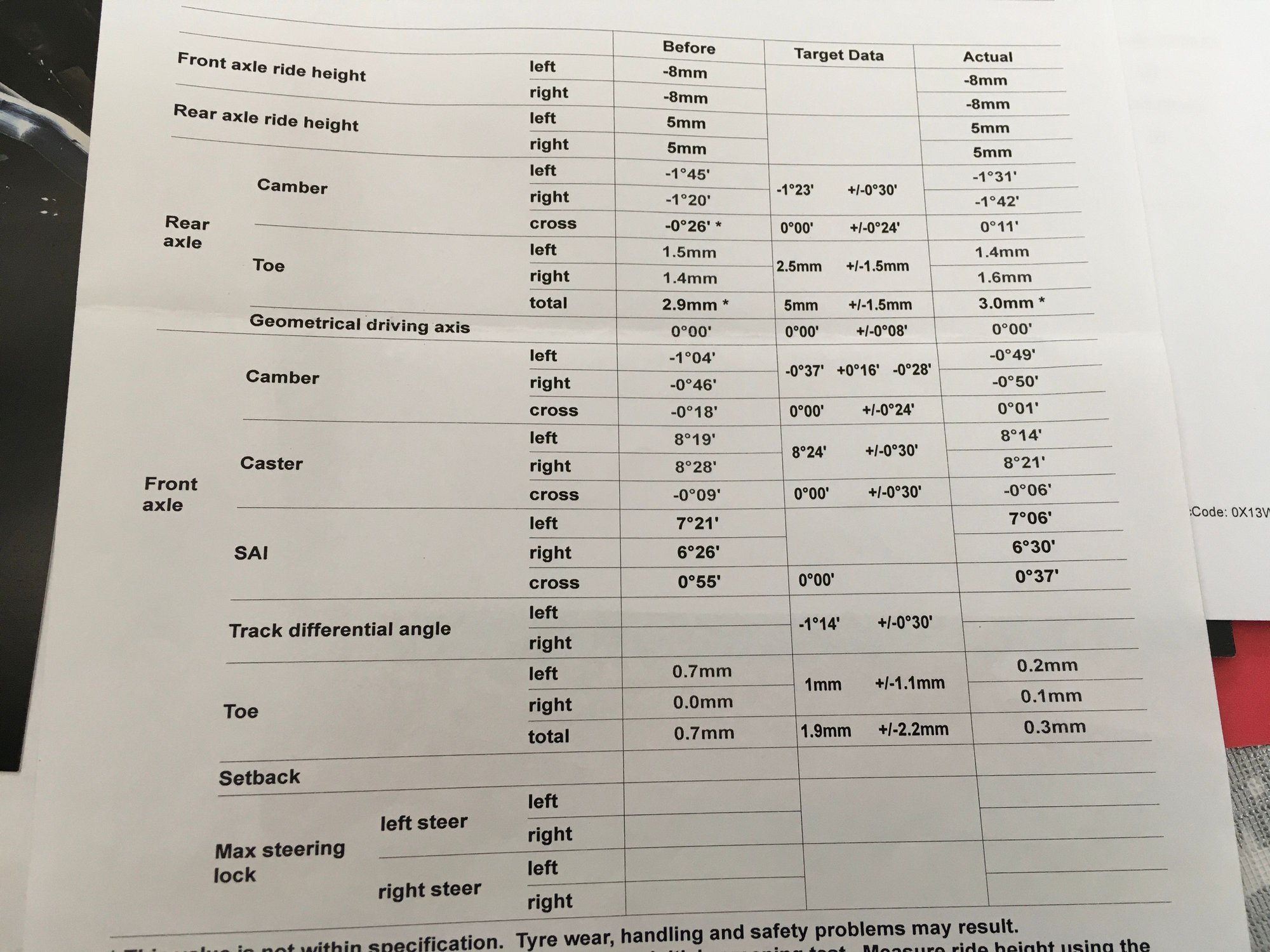

Here are some wheel alignment settings, for a 2017 GLC, diesel in Australia, so for RHD setup.
Hope this helps
20” rims, RHD, 2017 model with air suspension, 4Matic
