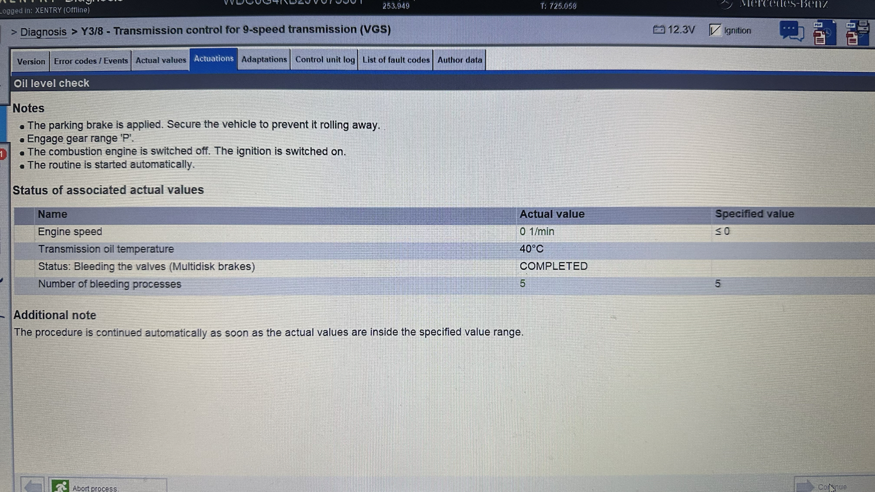

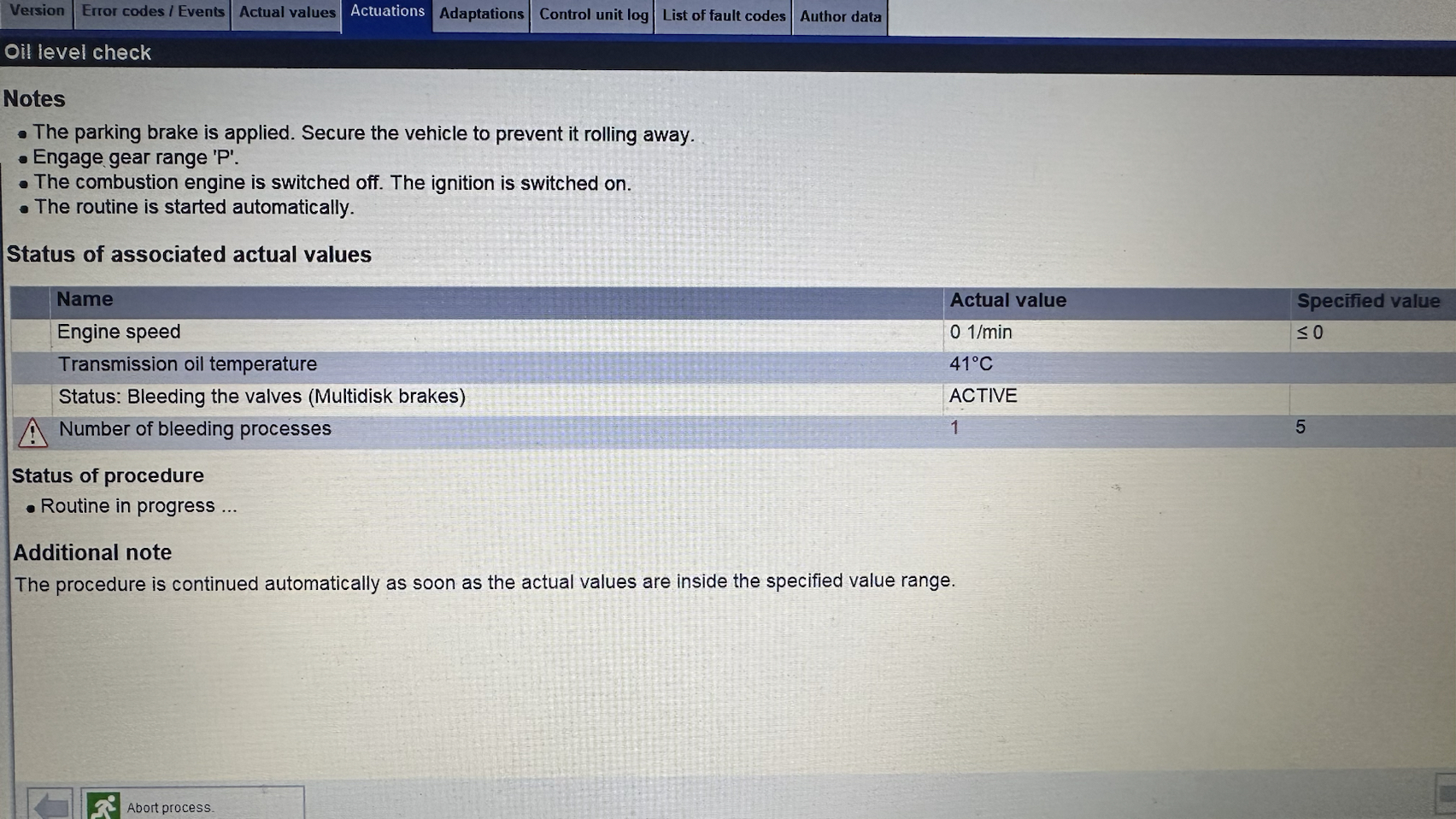

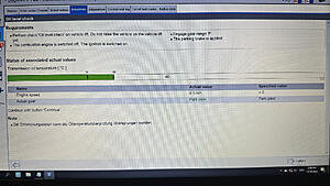

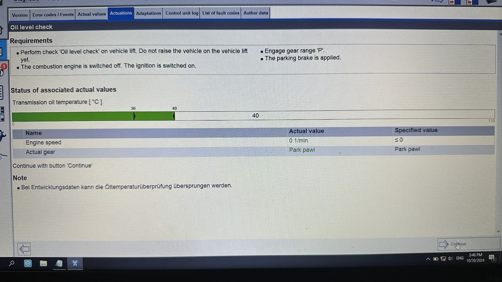

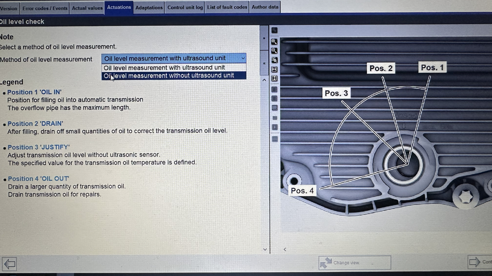

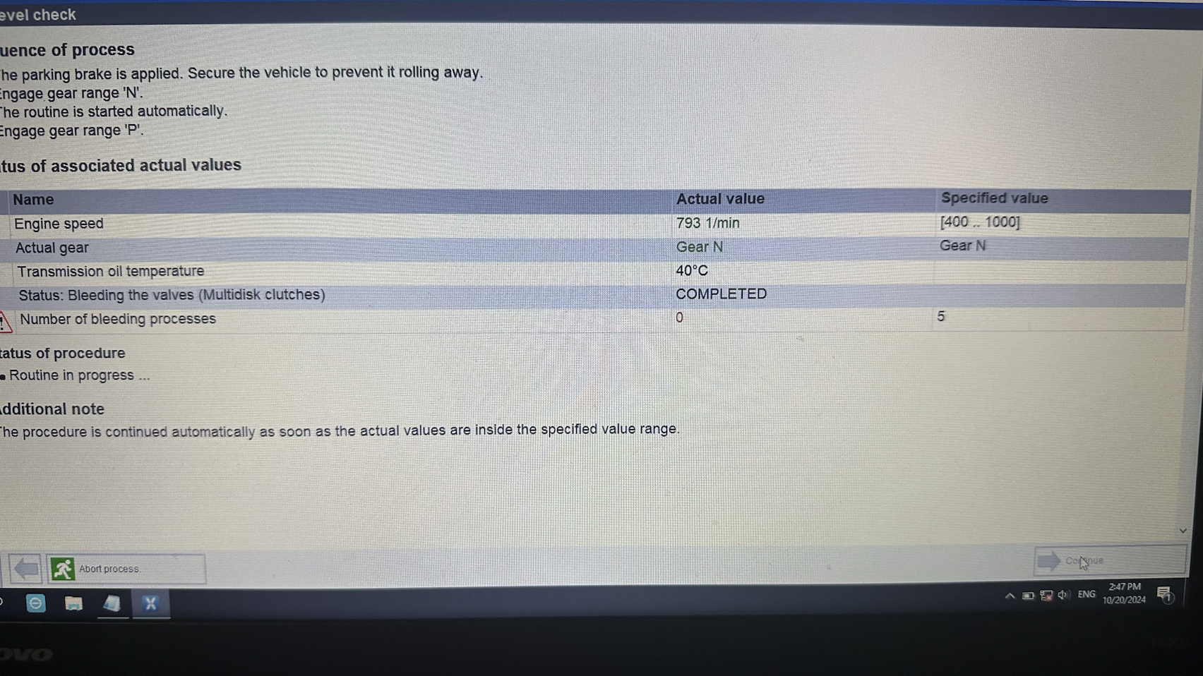

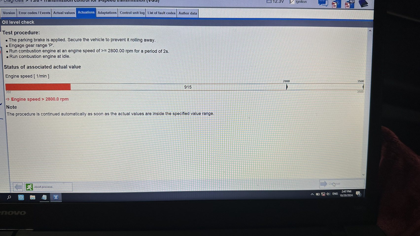

Just wanted to share some updates. I came across new information on this subject, and it's suggesting the use of an ultrasound sensor for oil level checks--a $2.5K sensor. So, I started searching further and found another document titled Check Oil Level in AT Without Ultrasound Device.
This document explains how to use Xentry's transmission block actuation. Now for the interesting part: there's a procedure run from Xentry when the oil temperature is between 35-40°C, with the engine off and ignition on. At this stage, valves 1-5 are bled (you can hear it, as the transmission is doing something).
Next, you start the engine, rev it over 2800 RPM for 2 seconds, then shift to neutral. The transmission bleeds the valves again. Once that's done, switch to P and you initiate the oil level check.
The car increases its idling, and you then switch to position 3 to check the oil level.
I took some pictures if anyone is interested in seeing them.
Attached Thumbnails 2017 GLC300 Transmission oil change-photo680.jpg   2017 GLC300 Transmission oil change-photo22.jpg   2017 GLC300 Transmission oil change-photo550.jpg   2017 GLC300 Transmission oil change-photo359.jpg   2017 GLC300 Transmission oil change-photo141.jpg
2017 GLC300 Transmission oil change-photo771.jpg   2017 GLC300 Transmission oil change-photo948.jpg   2017 GLC300 Transmission oil change-photo142.jpg   2017 GLC300 Transmission oil change-photo635.jpg

@DanD. - great post. I just did my 2018 GLC at the 6 year mark with 23.5k miles. I'm not sure how you would do it correctly without Xentry. Very defined steps as you share above.

If someone interested, i found short but I think is the most informative vid on how its done right.
Watch from 15.35
