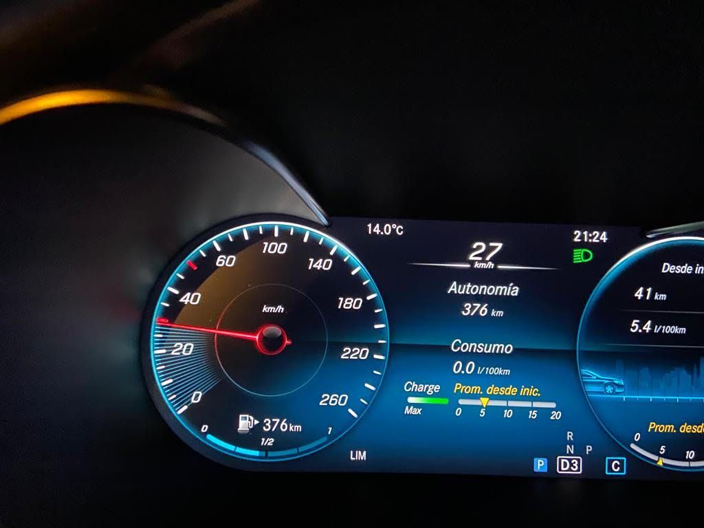

My GLC Coupe 200d (2020) occasionally (maybe 1 out of 10) has a consumption that is 3 times the normal one in the same route (short ones), I have seen that the Charge bar doesn't ever turn green when this happens and the consumption is of something around 3.5 when I stop accelerating, usually being around 0.0 like in the image. Not extreme cold yet, minimums of 6ºC. I attach an image of when it is correctly functioning, will take another one when it isn't.

That happens when your DPF filter is busy regenarating/cleaning itself and is quite normal. I go for a quick freeway blast once every second week to activate this process.
