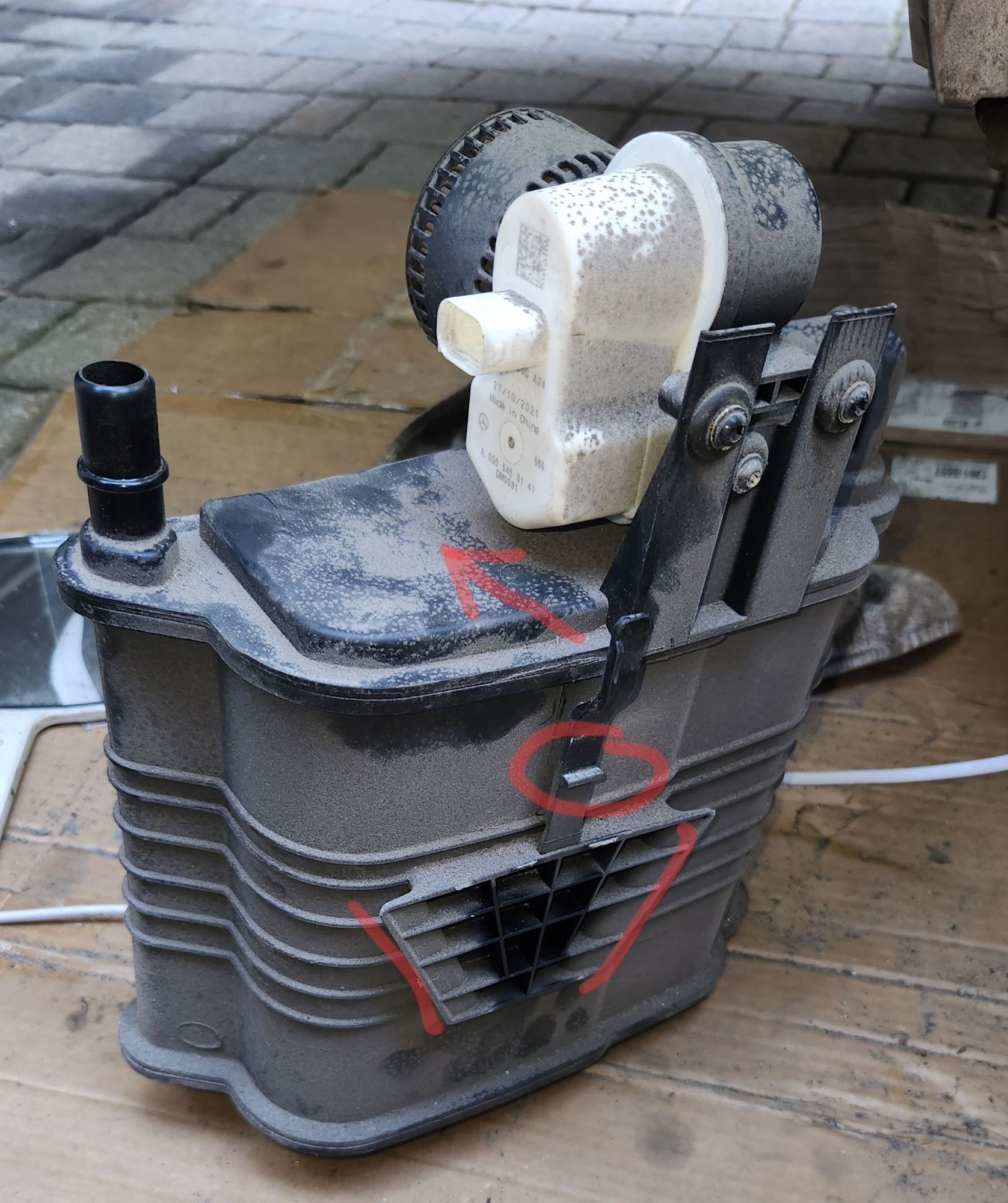

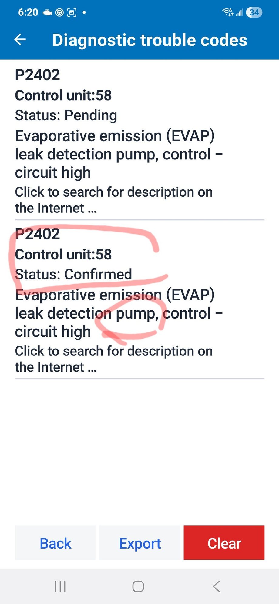

2022 Glc300 about 100K km (60K miles) got CEL with P2402. I cleared the code, and the CEL returned right after i started the engine.
I searched and found it must be most likely the Evap leak detection pump, which is very common failure.
I don't know if my GLC has the extended warranty or not as mentioned above.
But because the suspicious part is cheap, I didn't want to bother the Canadian MB dealership to check.
Pump part # is
MB A0005450141 (= VW 7L0906243D ). VW, Audi, BMW, Land Rover, Volvo use the same part.
MB oem is about C$100 and AliE is cheaper, C$40.

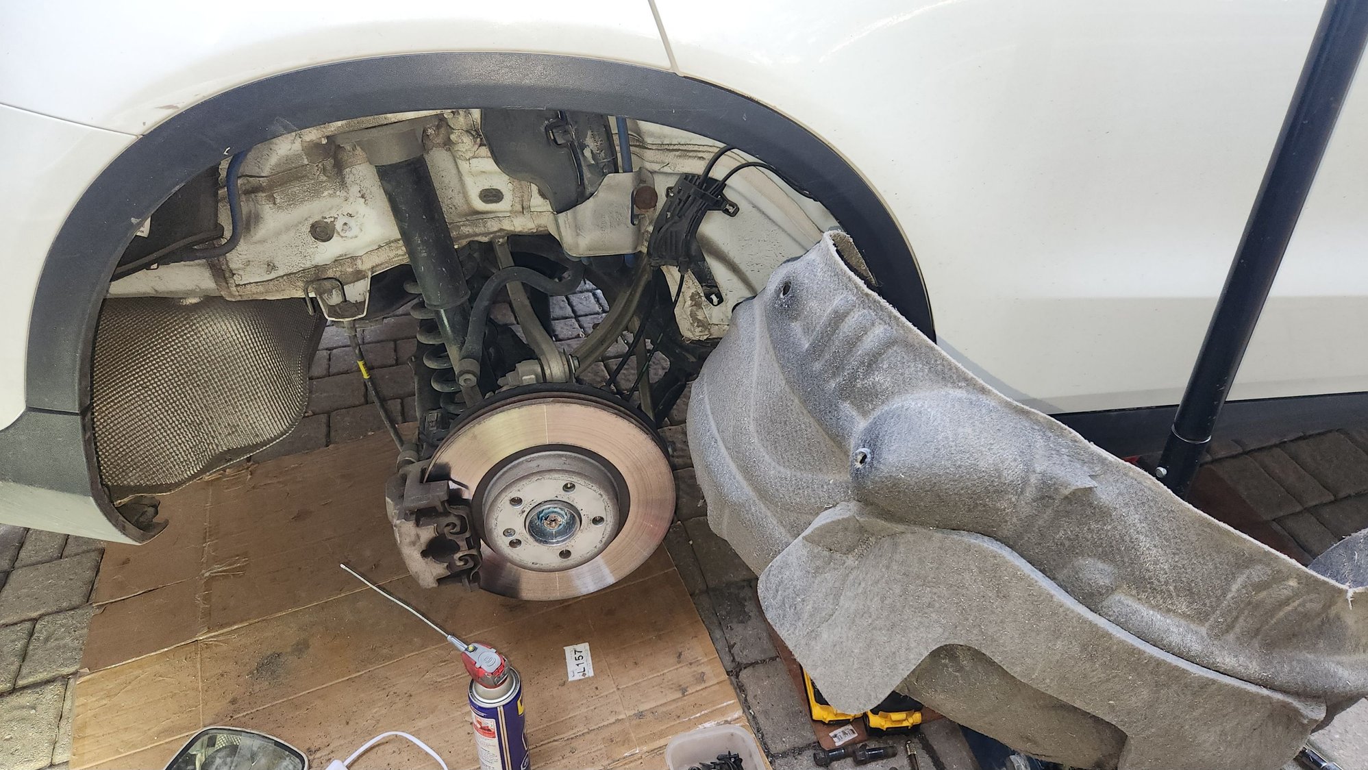

Today i got the AliE part and replaced in an hour.
I cleared the existing P2402 code and it's gone.
There are some youtube videos.
And my pictures here
