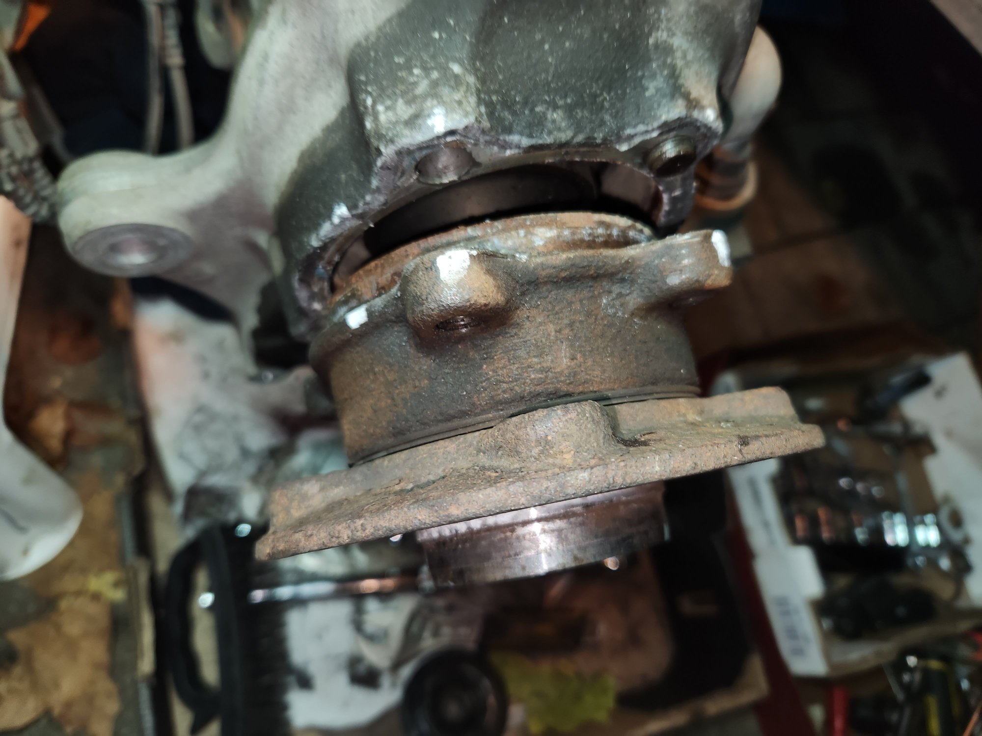

I've heard minor front wheel bearing noise 2 weeks ago, then became louder but couldn't diagnose the noise when I turned tires. So the noise level was I can say only 10%~20% out of 100% helicopter noise.
Tire tread was okay. Engine rpm doesn't affect noise. Transmission N from D position while driving doesn't change noise.

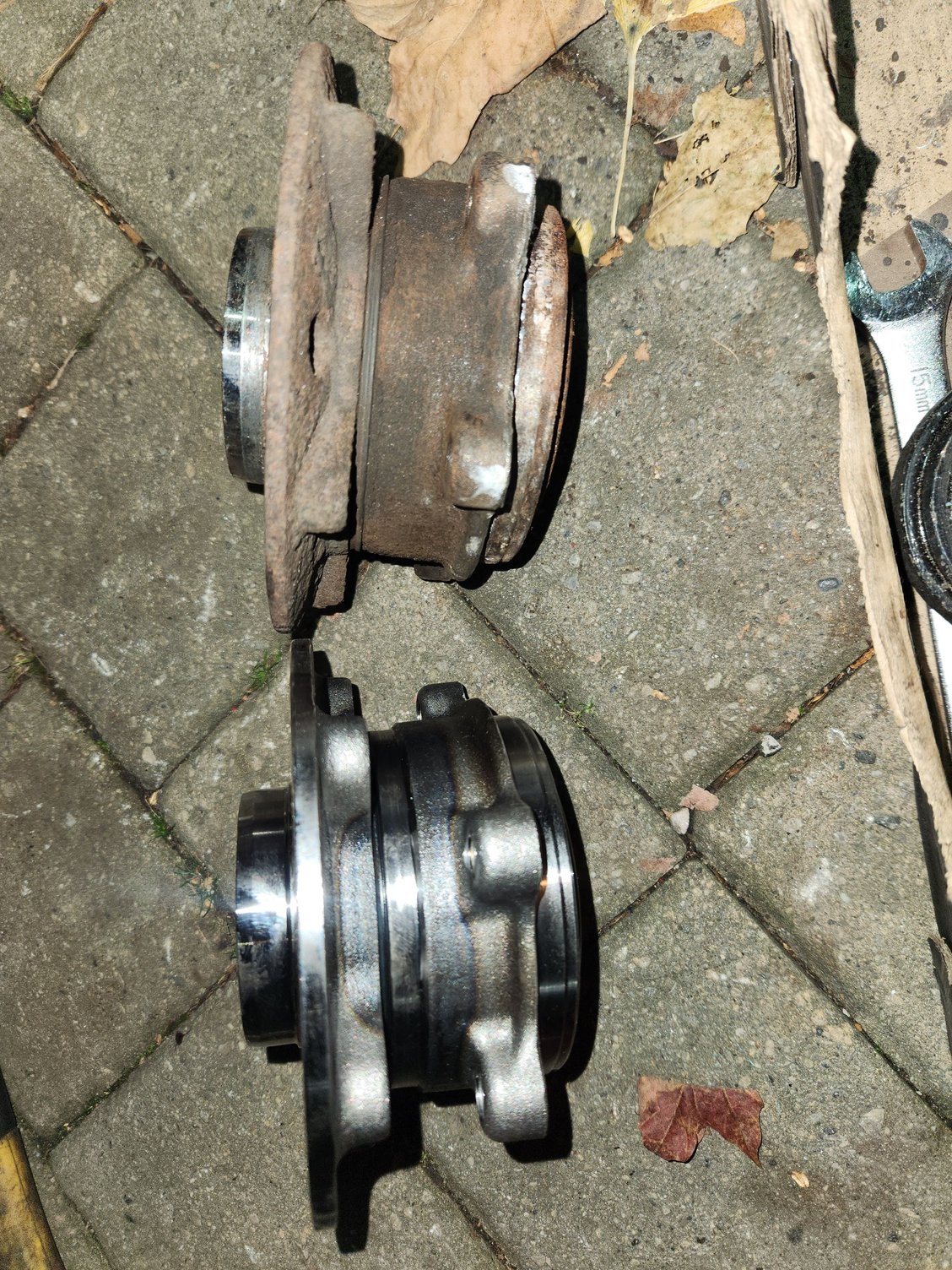

And I ordered C$100 wheel hub and replaced.
Hub bearing body didn't come out easily, I hhad to use a hammer and a punch, and hit 30+ times between knuckle and bearing body.
I found the bad bearing makes very minor click when i turned by my hand after removed.
My millage is 220K km. lots of pot holes driven.
