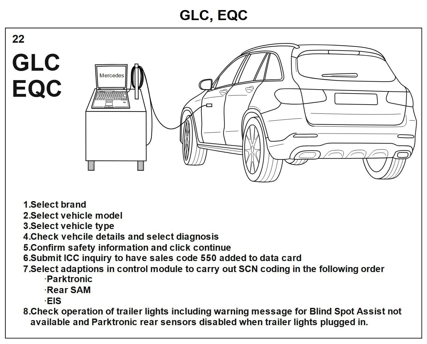

I found this on a towbar site in AU (no link, as it would probably go against forum guidelines). The instructions go into excellent detail on installation, and taking it to a dealer or indy to be coded:

2016 and cost was $3000 for bar, wiring kit and around 6 hours labour. Our click to open still works, never disabled. I posted back then the install paperwork MB uses. Time might have been a bit long, but we probably were helping them train staff. That said, the documentation did state how much time should be allocated. Westfaila was only option back then. One issue, depending on ball weight, rear steel springs and shocks can suffer from bump stops engaging body when travelling over uneven or rolling road systems. I always insist on all documents and sometimes packaging when work done, incl old pads, discs and air filters in boot after service. Several times we suddenly did not have to replace discs !!
