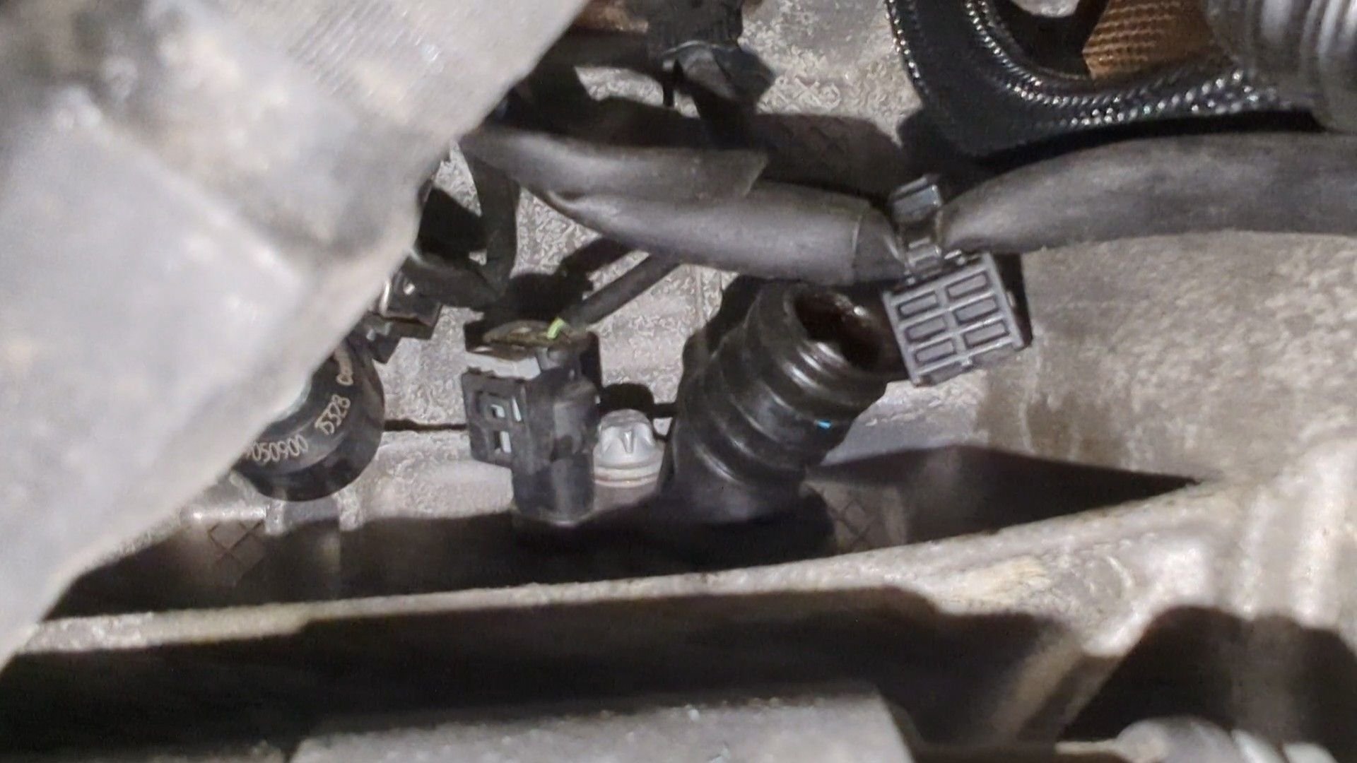

Has anyone else has had to replace only the Crankcase Ventilation Oil Separator / breather tube, PN 2740180321 (not the entire breather valve assembly). The snorkel tube part of it broke when I was replacing the fuel line, ugh. Literally snapped in half. I haven't seen any videos or forums where that spedcific part was replaced or even in addition to the entire assembly. Can't quite figure out hot to get to the lower portion. I can see it with a camera way up there and reach it but can't get tools up there to remove the bolt and also disconnect the electrical connection. Such a simple part for <$100. I don't have a lift at home. Thanks!
