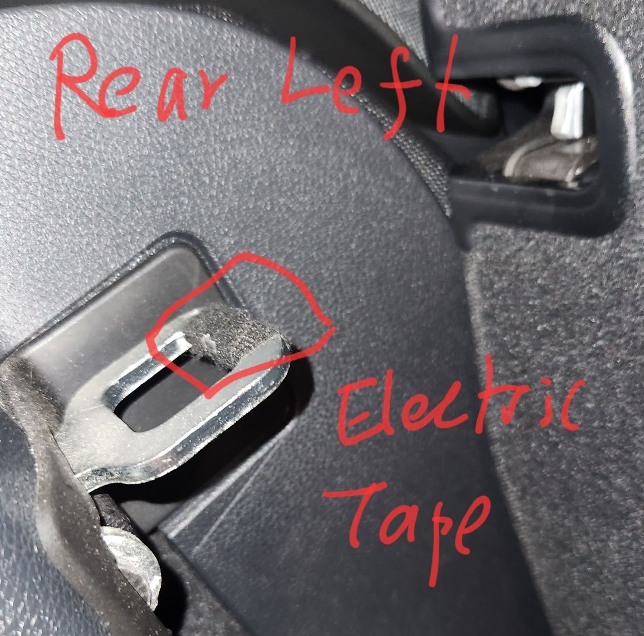

Rattle noise at rear seat area. Fix
I have 2017 and 2022 glc300 and found the same minor plattic/rubbing rattle noise. And the fix was the same on both model years. It's just adding some electric tape round on the rear seat's 3 folding hooks. I used the black cotton tape.
if you heard the strange annoying rattle, try it.
