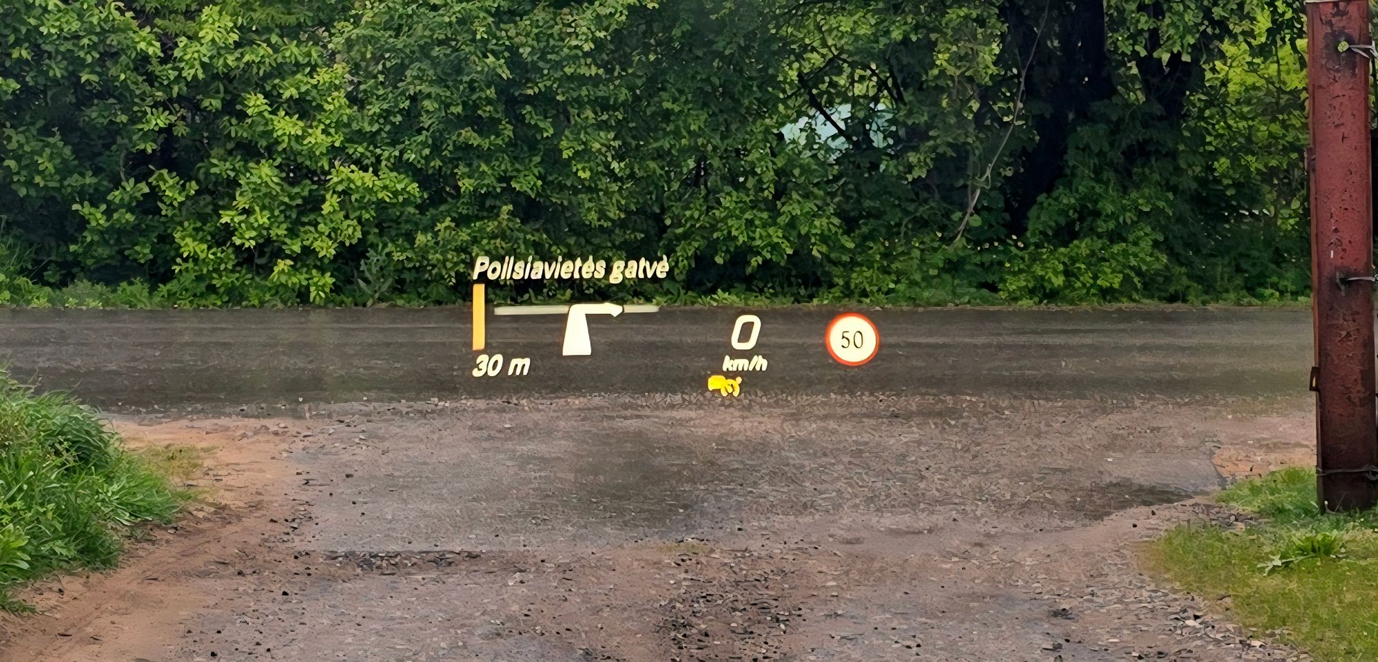

Hi, I have Mercedes GLC300e, 2020, C253. Original from factory without HUD. I already bought all OEM parts for that and want install it. Someone maybe done it before ? Maybe just can share some experience ? Any information it will be very interesting.

HUD for my car number A2539001004. I find used, cost 220€. I think brand new cost around 1500€. Frame in dashboard A25382003009116, brand new price approximately 70€ and air duct brand new A25383160001, price 30€. Also you must be changed windscreen. Because if without HUD it will be double view. Not original including replacing cost 350-400€

You need to verify that the IC module has the HUD out option, otherwise you must change the IC module for one with HUD out (white connector).

Hi, yes, thank you. I have checked before start installation. Now all done, HUD installed
and working. I'm very pleased.
