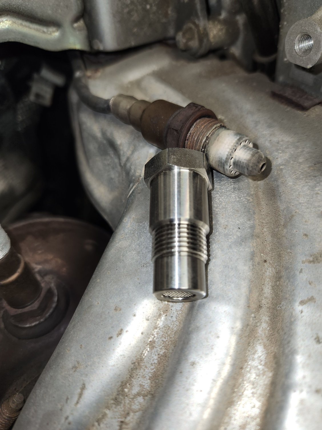

I've seen this code and CEL for months at my 2017 GLC300,
P0420 [0x0420] Catalytic converter system, bank 1 -efficiency below threshold
Finally installed the adapter into the 2nd o2 sensor(under the engine air filter housing), which will reduce the sensing ability by the longer distance, and mimic the cat working better.
and it cleared the CEL right after I start engine. Not bad. $5 adapter from AliE.

P0420 is gone, but got another one.
P013F Heated oxygen sensor (HO2S) 2, bank 1 - delayed response lean to richStatus: Pending
Maybe too long adapter.

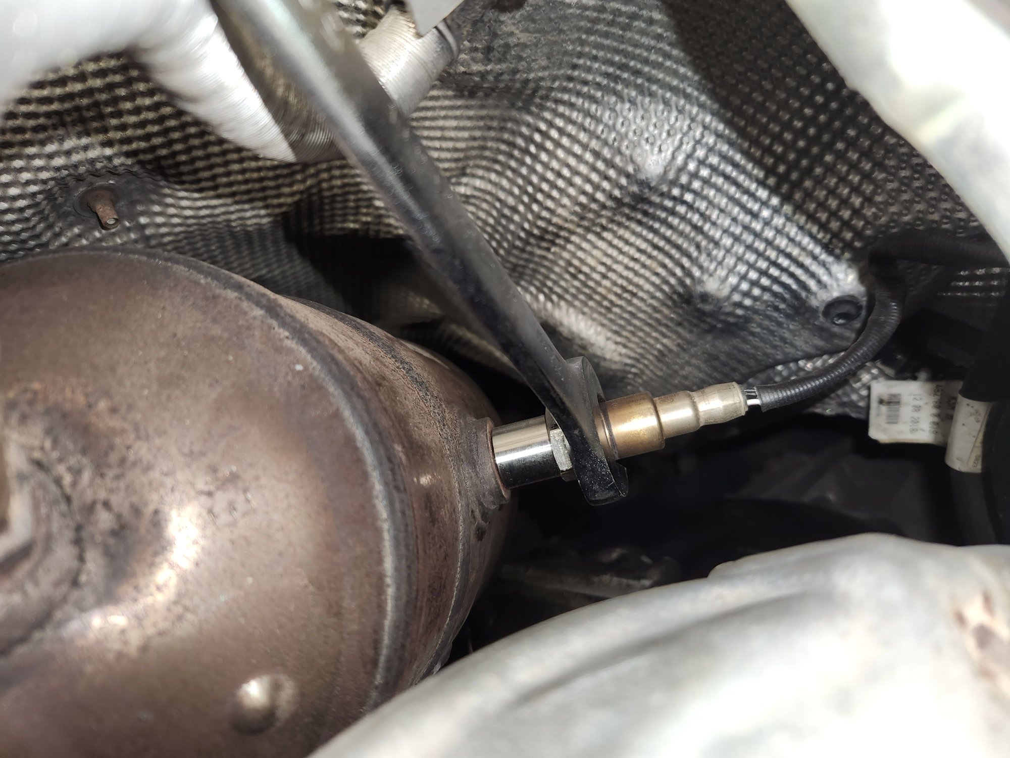

Just to update.
P0420 (Cat efficiency) then after the adapter, got P2187 (too lean at idle) until today.
Finally I bought the downstream O2 sensor A0075426418 from Ali under $30 and installed without the adapter.
No more any codes. All good now.
I looked at the O2 sensor hole, and the cat looks all clean good.
