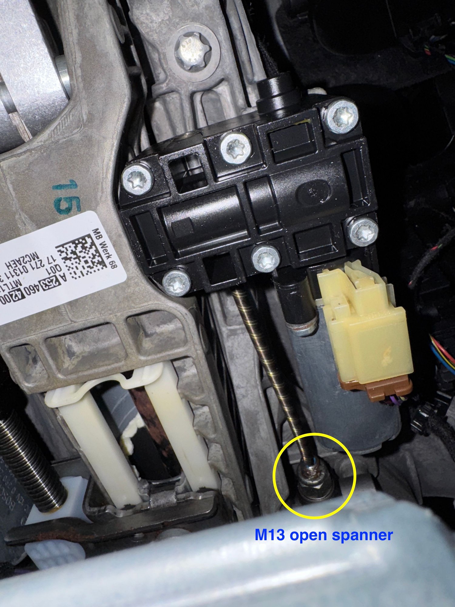

Tried whacking the steering column forcefully in all sorts of directions when it got stuck and still wont budge.
Right Hand Drive 2017 GLC43. Should be similar.
Remove the panel covering the knee airbag. T20 x 2 pcs. Lie on your back facing the steering column and you should be able to see this.
Activate the handle for the steering column UP & DOWN and note the direction. My motor and flexible rod rotates clockwise >> use a M13 open spanner and turn the nut circled in "yellow" clockwise; I need to turn roughly 30 degrees before the nut broke free and able to rotate upon activation of the handle .
Lube the threads (left side of picture) and the steering column had been working great since last year September.
