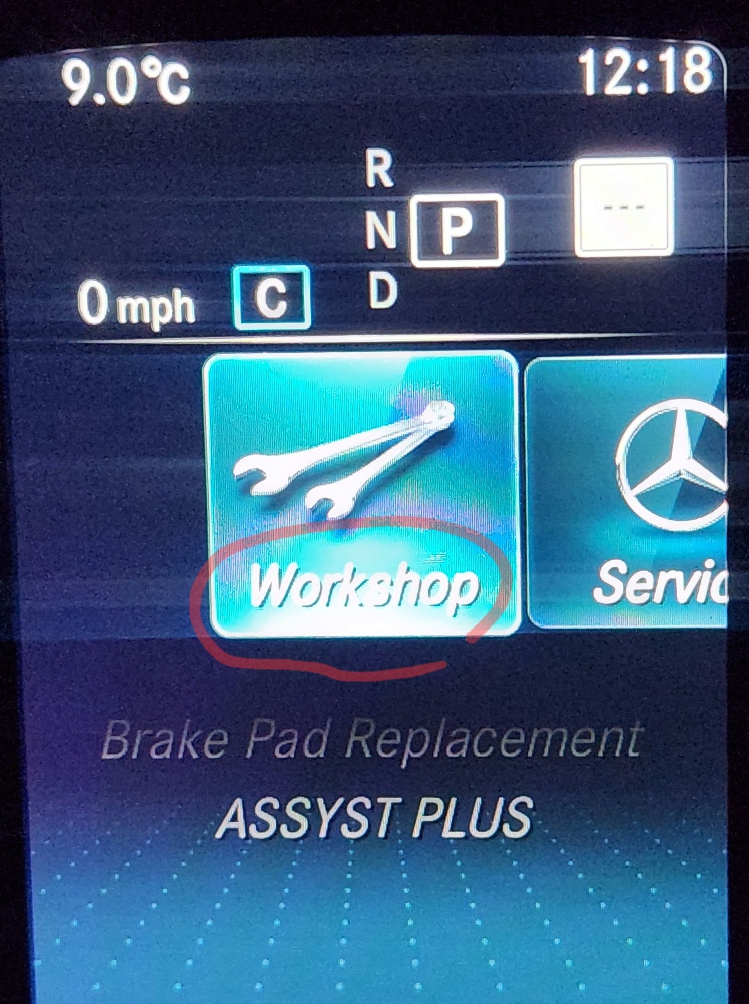

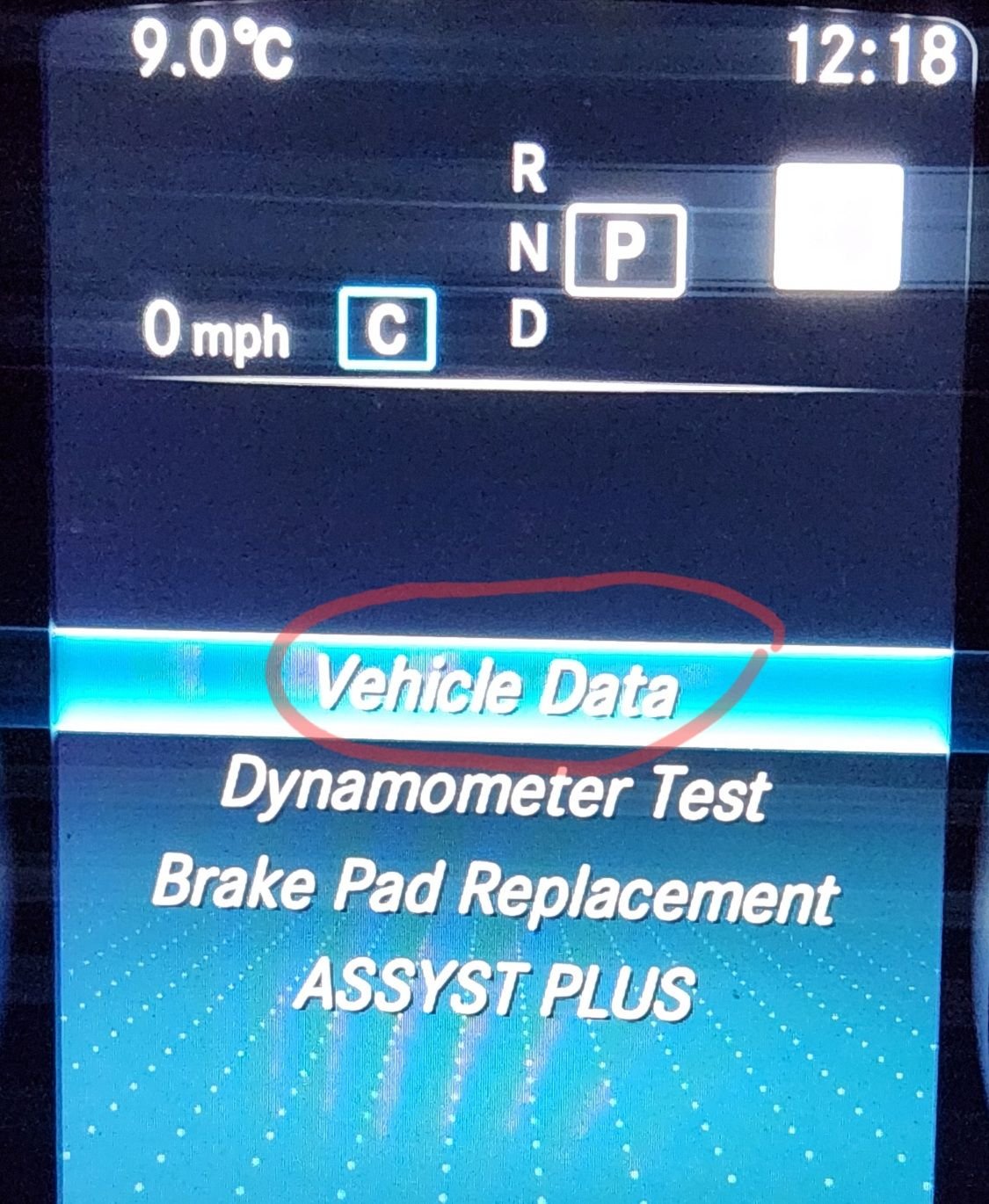

2020~2022 glc300 M264 engine have NO dipstick for the oil level checkup and the oil extract tube.
Instead, dash display menu, oil level can be seen at menu:
1. Service. As Image.
2. Workshop. As Text.
- Here's i drained the hot engine oil for enough time, 15+ minutes. Then added new oil, 6.5 liter.
​​​​​- my OCI is 3k~4k miles (5k~6k km). 5w40.
- Oil level measure conditions, hood closed, oil is warm (engine idle 10+ minutes)
1. Service menu
2. Workshop menu
