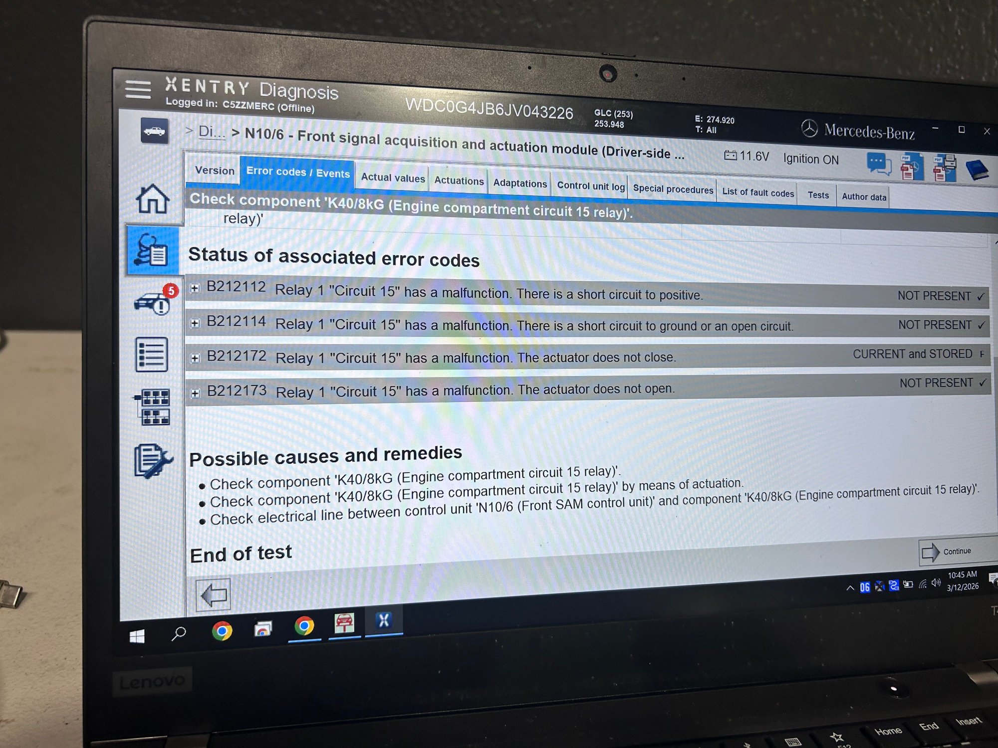

This is the codes I just got when I scanned it with no granny in

Need help finding out what relay is “relay1 circuit 15”

For the Mercedes-Benz Model 253 (GLC-Class), the K40/8kG relay is the Engine compartment circuit 15 relay. [1, 2] Location & Accessibility• Relay Location: It is located within the K40/8 Engine fuse and relay module.• Module Location: The K40/8 module itself is found in the main engine fuse box, which is located under the hood on the driver’s side (for left-hand drive vehicles).• Internal Placement: Relays J, K, L, M, and O (including the kG variant relay in similar modules) are often soldered directly onto the printed circuit board (PCB) inside the K40/8 housing. This means they are generally not "plug-and-play" and typically require the entire module to be replaced or professionally repaired if the relay fails. [3, 4, 5, 6, 7] Key Component DetailsComponent [1, 8, 9, 10, 11] FunctionIdentification
K40/8kG
Managed by the Front SAM (N10/6)
Circuit 15
Switched ignition power (Ignition On)Controls voltage to engine and control modules
• Inspect the Module: The K40/8 module is the central unit within this box that holds several fuses and the internal PCB-mounted relays. [3, 4, 12, 13, 14] If you are experiencing electrical issues related to Circuit 15 (such as a "no start" or loss of ignition power), you may need to inspect the K40/8 Engine Fuse and Relay Module (OEM part A2059067200 for newer models). [10, 15]
