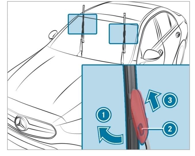

can anyone of you post step by step how to replace front wipers? I try in allways, but I can only take them off with entire mechanism... How to replace the blades it should be easy, one click, but even with the official manual I'm not able to do it. Please be so kind and post it step by step. Model is X254. So the wiper plastic mount looks different then in x253.
Is the red part integrated with the wiper, or it's should realese the wiper blade? I'm only able to take off the blade with this part...

Press the tab slide upward a bit then tile the entire wiper about 30 degree then slide upward again.
