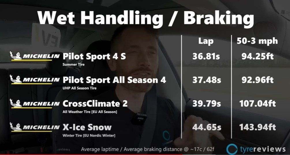

Unless you use dedicated winter tires, I would go for Cross Climates against the PS AS4 for winter traction. I have PS AS 4, great for dry/wet, but slides very good on ice on NYC shore in winter mornings. I have winter Alpin 5 tires and Cross Climates are closer to that in snow/ice. Cross Climate is all weather / all season tire with 3 peak mountain and snowflake (3PMSF) symbol to meet a snow traction requirement of a winter / snow tire. I got my winter tires from Costco as my GLB came with summer tires also. The problem is the winter / all weather tires-CrossClimate2 might be sold out.
Tirerack test: https://www.tirerack.com/tires/tests...r.jsp?ttid=270
Stopping distances from tirerack tests:

Dec 10, 2023 | 10:49 PM
Quote: Unless you use dedicated winter tires, I would go for Cross Climates against the PS AS4 for winter traction. I have PS AS 4, great for dry/wet, but slides very good on ice on NYC shore in winter mornings. I have winter Alpin 5 tires and Cross Climates are closer to that in snow/ice. Cross Climate is all weather / all season tire with 3 peak mountain and snowflake (3PMSF) symbol to meet a snow traction requirement of a winter / snow tire. I got my winter tires from Costco as my GLB came with summer tires also. The problem is the winter / all weather tires-CrossClimate2 might be sold out.
https://www.youtube.com/watch?v=421HkK4Nqss
thank you so much! Found the crossclimate at Coscto!
