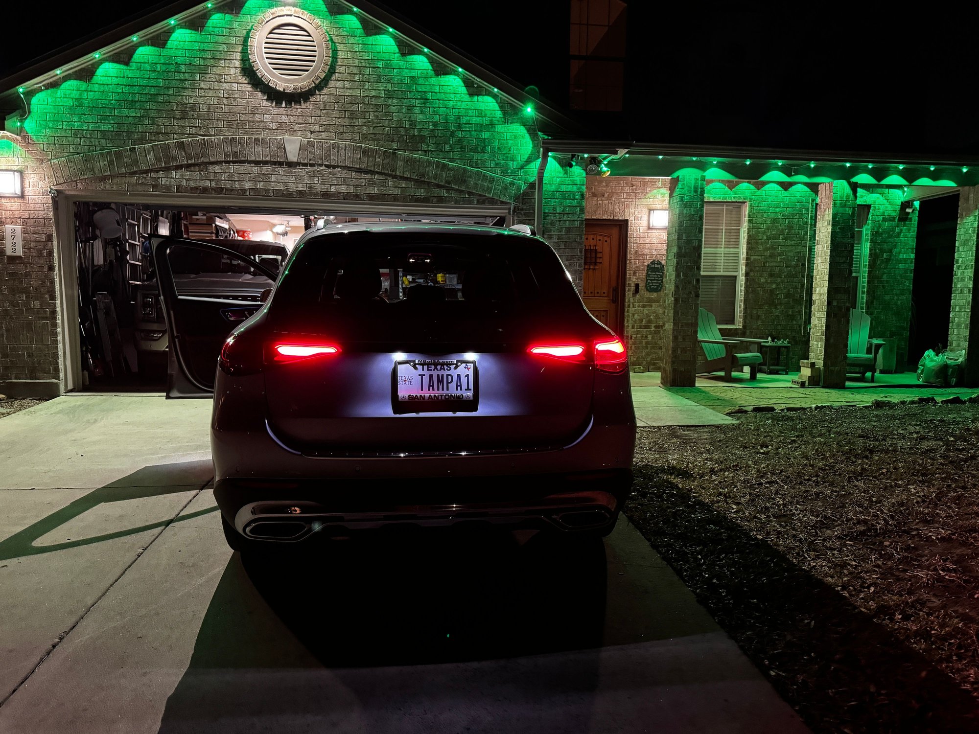

Over the weekend we were at a friends house who were hosting a reception. We parked our car on the grass along the driveway with other cars. About 90 mins after we got there we noticed the rear passenger brake light was lit. Nothing on the driver side and it was bright red as if the pedal was depressed vs soft red as if the lights were on. I tried locking/unlocking via the remote and that didnt do anything. I went to the car and noticed the front passenger lights (not the headlight) we also illuminated.
I got int he car, started it and waited a minute or two before shutting down, getting out and locking it. The light issue was still there and didnt resolve until we drove hour a few hours later.
It hasnt happened since but wondering if anyone has seen something where 1 side of the car had its exterior lights on?

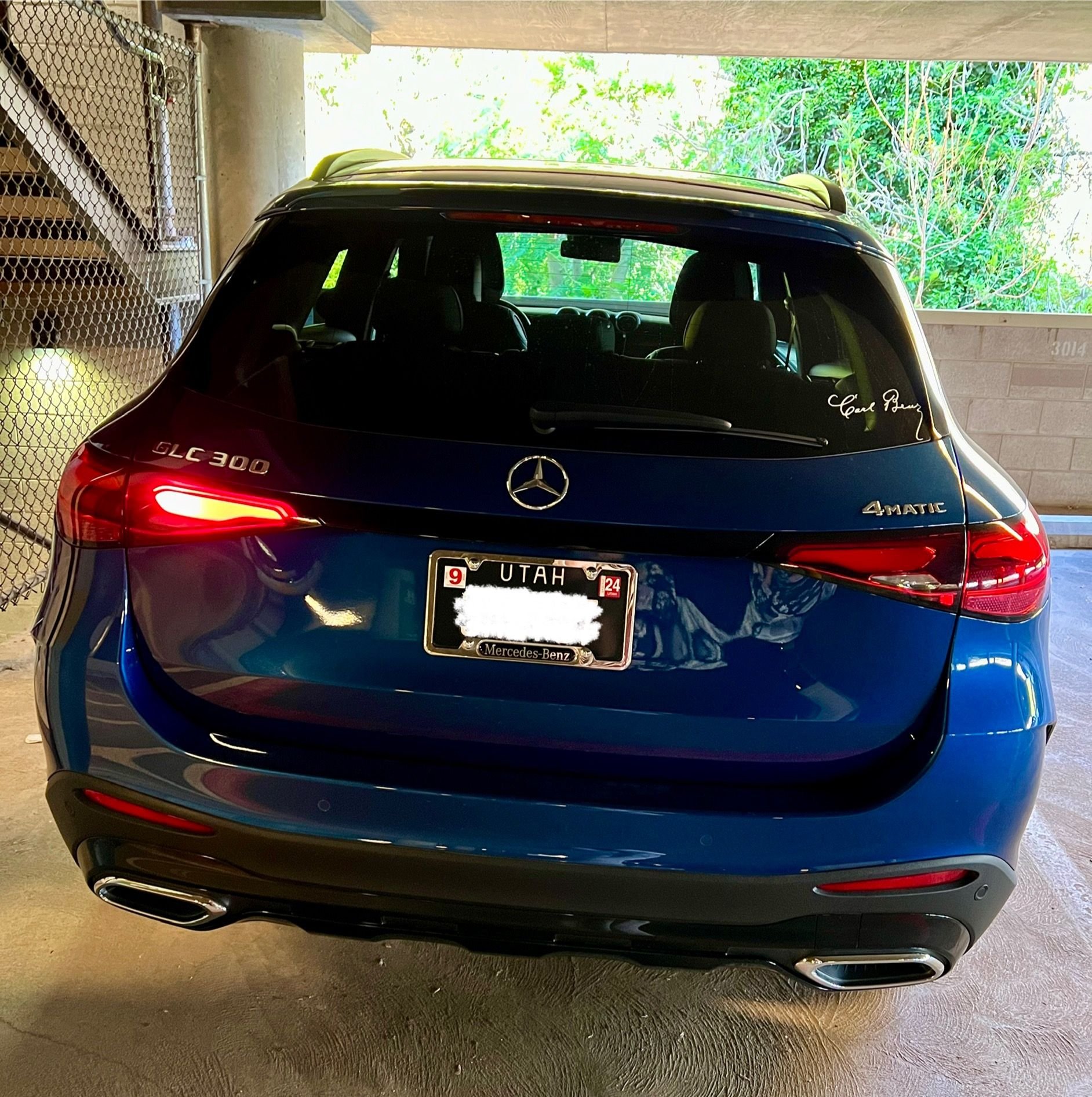

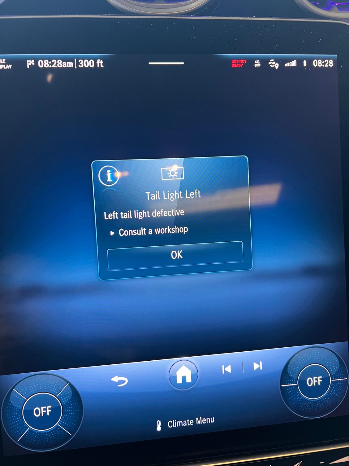

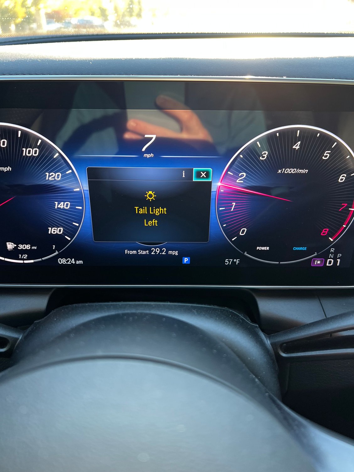

I’ve had this happen to me. Drivers side tail light is staying on, or illuminating when approached with proximity key. When started I get this error message. Dealer cannot replicate the problem as the error message goes away and comes back intermittently.

Had something similar. But it was with the front low beam lights that gave an error message. I took it to the dealer they did a software update. Got it back few days later same thing. Took it back to the dealer this time they replaced the whole lighting unit on both sides and haven’t had a problem since. That’s the only problem I’ve ever had with the car.

had the same kinda issue they replaced the whole tail light
