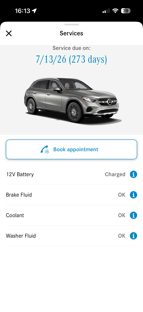

Ah Palermo. For us here in the USA, we can check the status of the 12v battery, but it only shows if it is ok or not. In the app, click on Service, and this list is in there.
