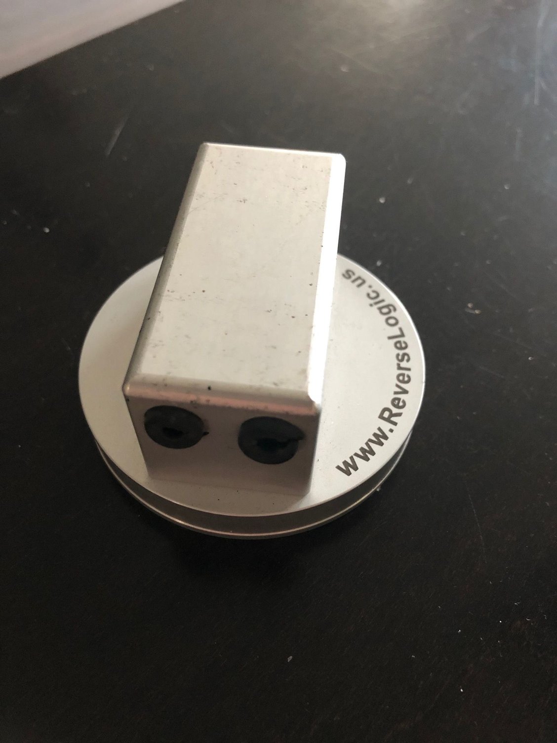

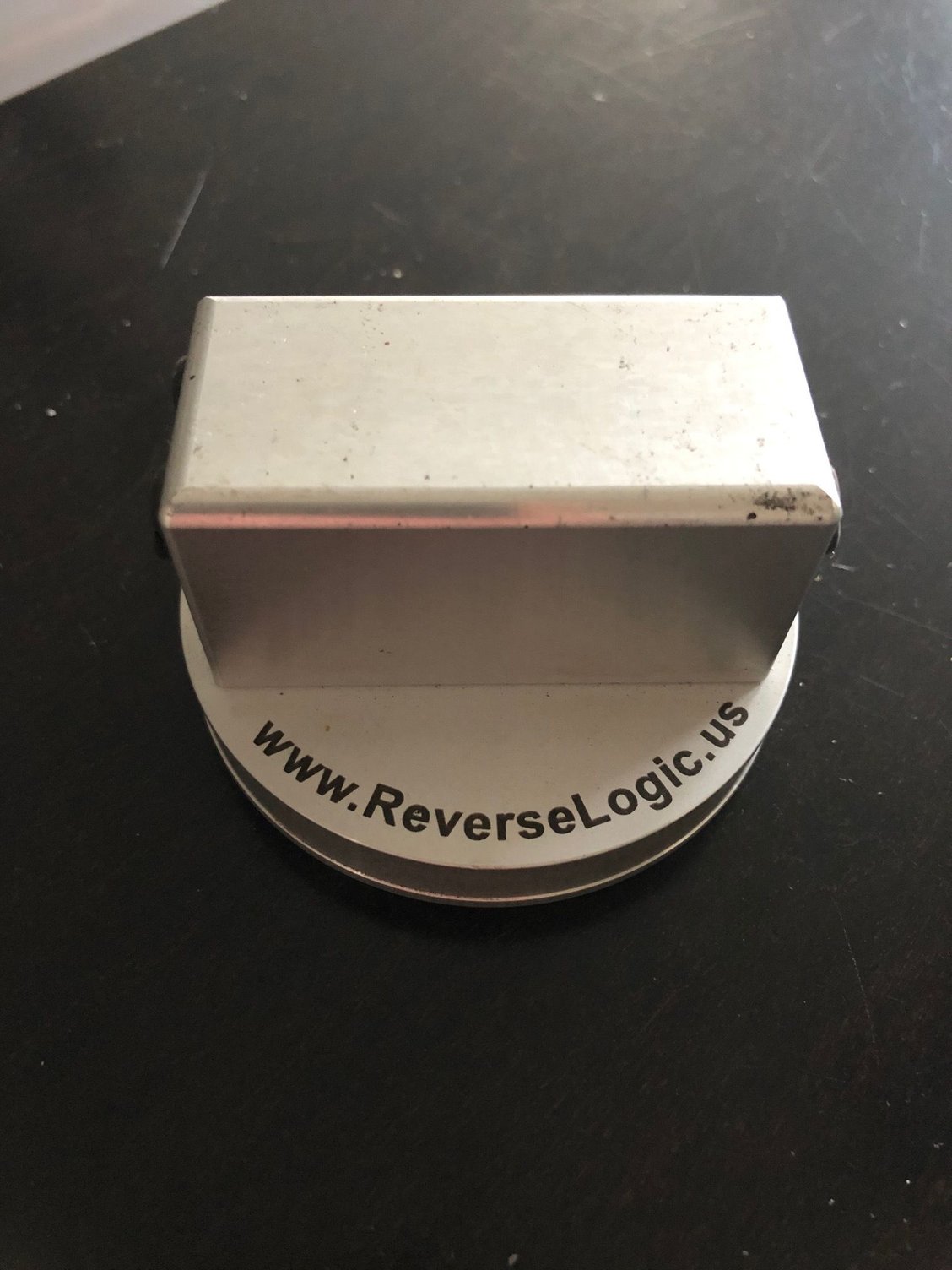

Old May 5, 2020 | 07:28 PM
  #31
Tylbran's Avatar
Joined: Feb 2015
Posts: 203
Likes: 28
From: Thornhill, ON
2018 GLC 43 & 2014 SLK 350, gone 2016 E63 Wagon
I purchased this jacking block from Reverse Logic - works great for 2018 GLC and 2014 SLK.
Reverse Logic jacking block
Reverse Logic jacking block end view

Originally Posted by mrmotoguzzi00
nothing specific, literally a square chunk of 2x4...
In the past, I used a piece of wood as well.
Last time the wood slipped off the jack and jack almost damaged my side skirt.
That's why I'm looking for a jack pad that will fit securely in the MB jack adapter.
Thanks.
Old May 6, 2020 | 01:27 PM
  #33
stevebenz09's Avatar
Joined: Dec 2015
Posts: 18
2020 AMG GLC43
You can get the jack pads on ebay. I bought mine on there. They look like what Tylbran posted above and are made from hard rubber.
