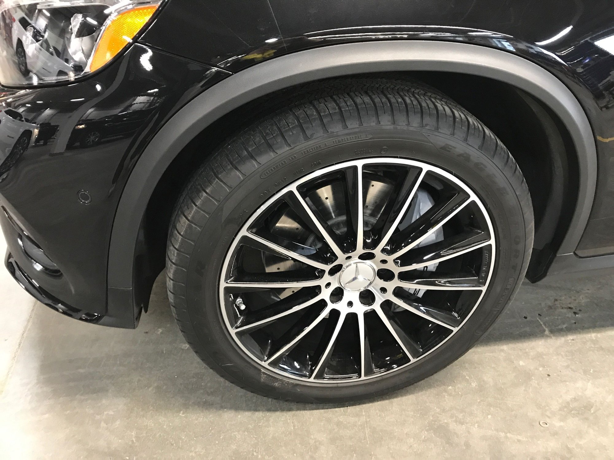

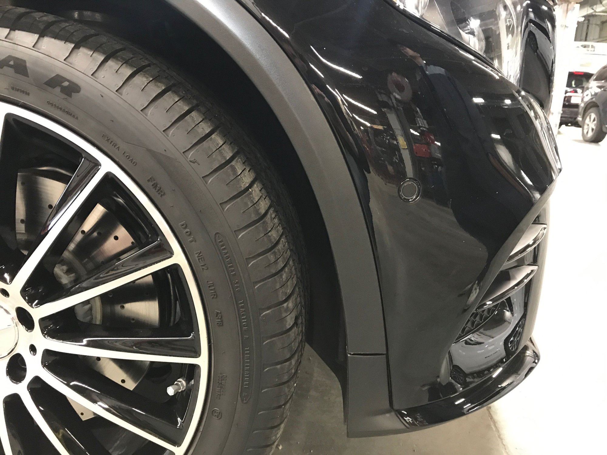

Body shop did. Mercedes wanted 180 bucks per hour times two. I paid $89 at the body shop.
For people wanting to did this as well, I have to warn you it’s not a direct replacement. The 63 flares are longer in the front. Three tabs don’t line up. The body shop had to cut the flares to the proper length and cut a couple tabs off. I’ll attach pics to show you guys when I’m back in town.

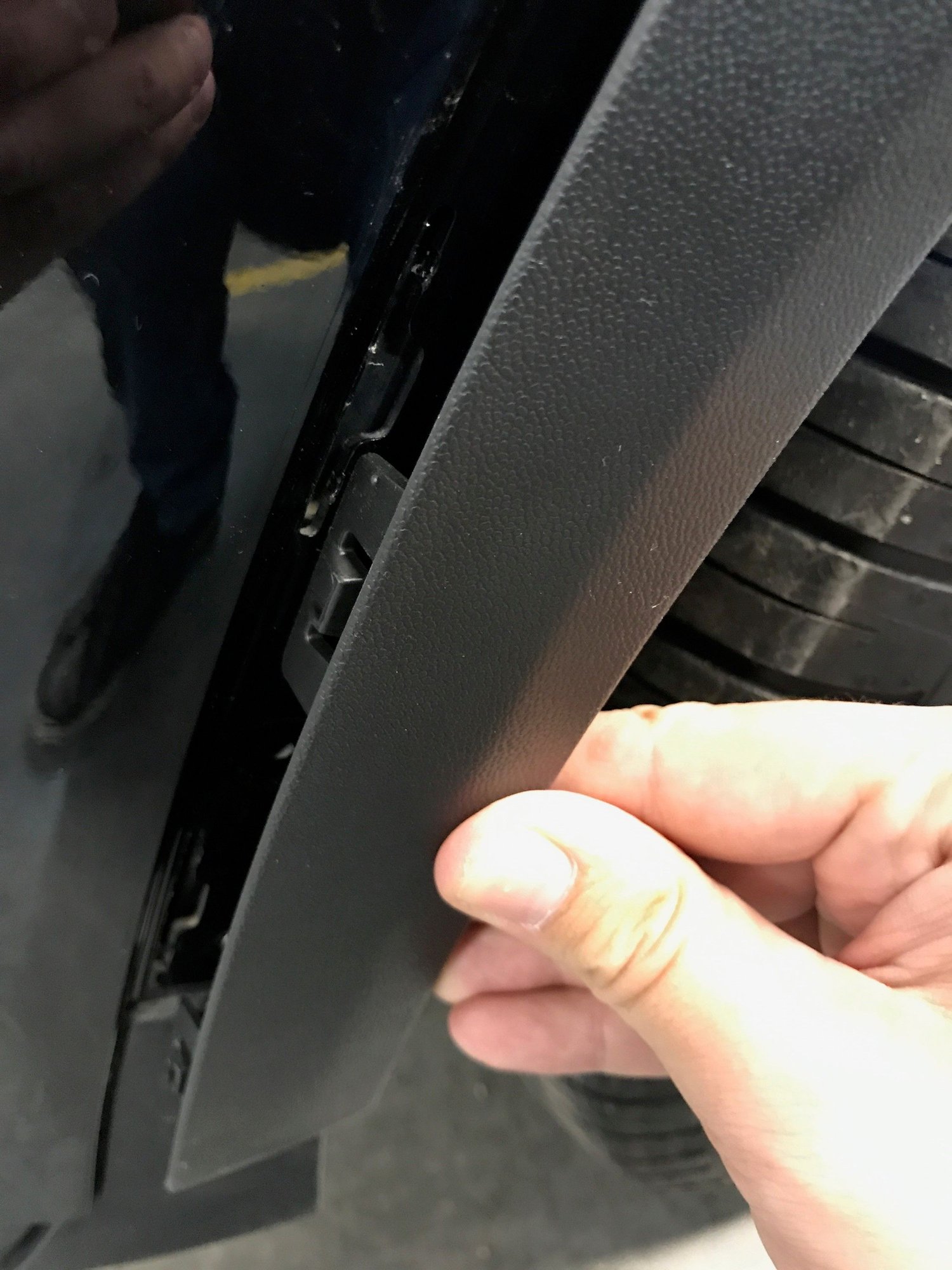

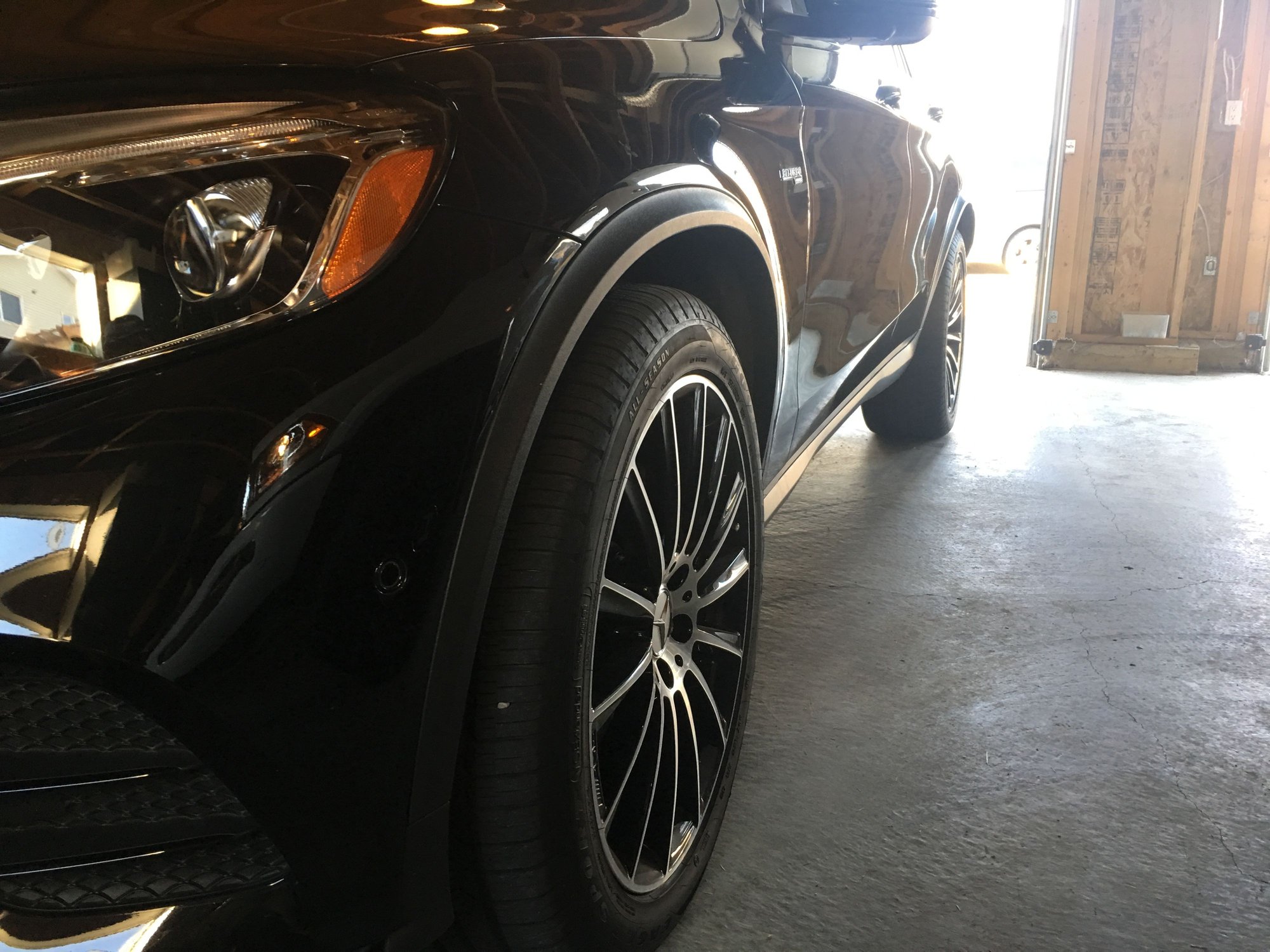

Here's some pics of the flares mocked up:

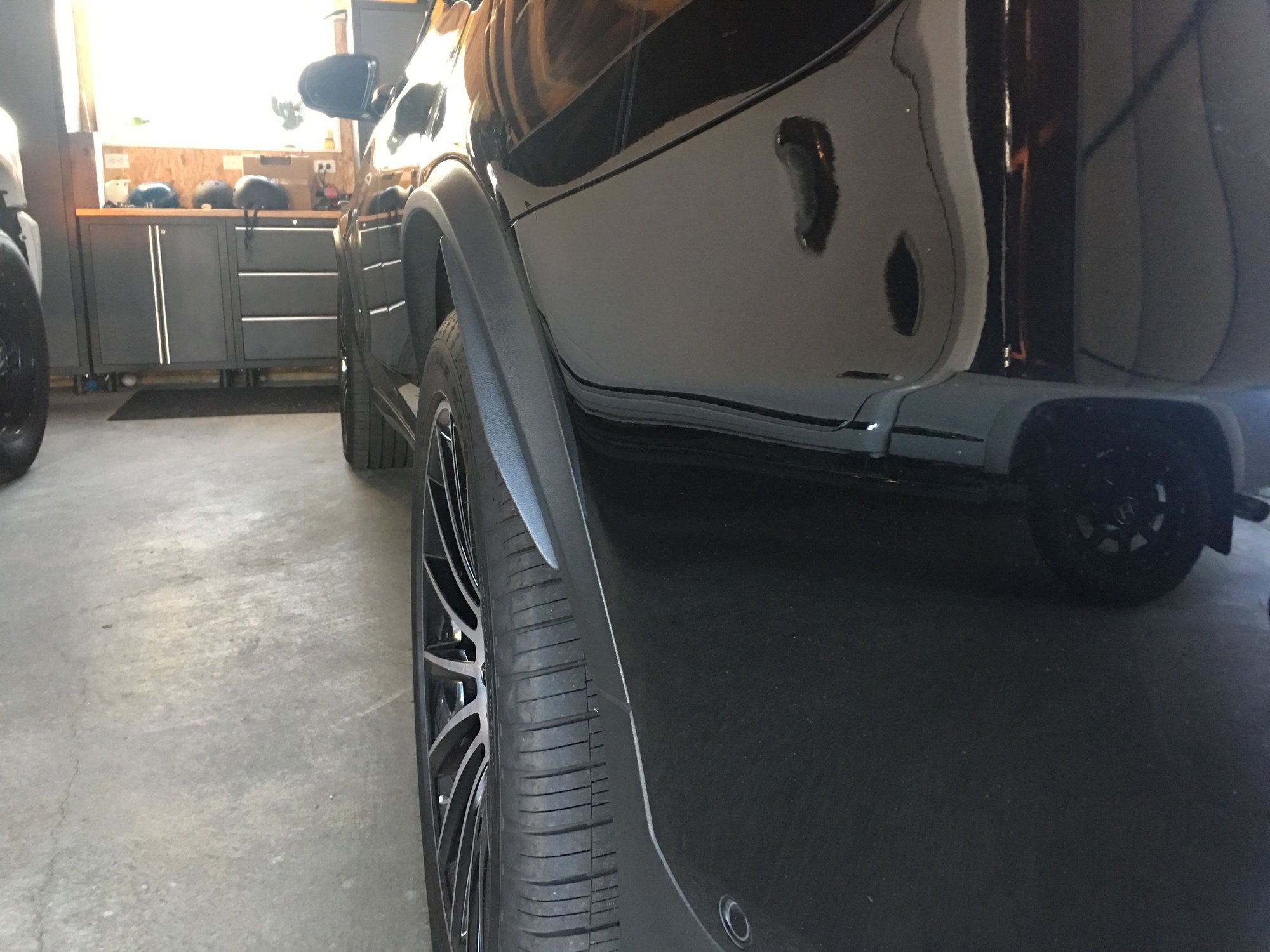

It does look great though with the 15mm spacer I put on the front of the car.
R.K.
Do you have pictures with the spacers ?

I'm pretty sure he's just showing us that they aren't a direct fit, and what would need to be modified to make them fit the 43. You can see how the tabs don't line up, and the overall length needs to be trimmed. Looks easy enough to me, but I would imagine most here would need a small body shop bill to make them work.
I'll take some tonight and post them.

I can see but on thread #27 radride said " The body shop had to cut the flares to the proper length and cut a couple tabs off"
Did the shop cut the tab on the flares are made opening in the fender and that's more serious job .

They just cut the tabs on the flares themselves. Applied double sided tape to that area. The flare itself is really only held on by double sided tape from the factory.
See attached. Same outside wheel fitment as a GLC63 with 20" wheels.
R.K.

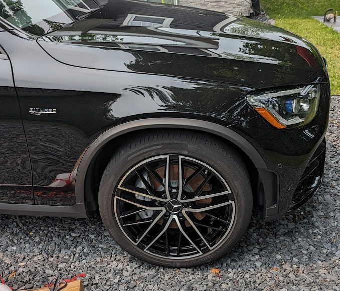

Reviving this thread from a while I know but I've bought some GLC 63 flares for my 2022 GLC 43 from AliExpress and fitted them on this past weekend. Was doubtful buying from there but the quality was quite decent.
Had to cut off something like 8 inches off the front of them since the facelift bumpers have side vents. You can tell they've been cut because the "bulge" starts lower on the 63 than the vents, but I don't actually mind. Now I need wider spacers to fill this additional gap
