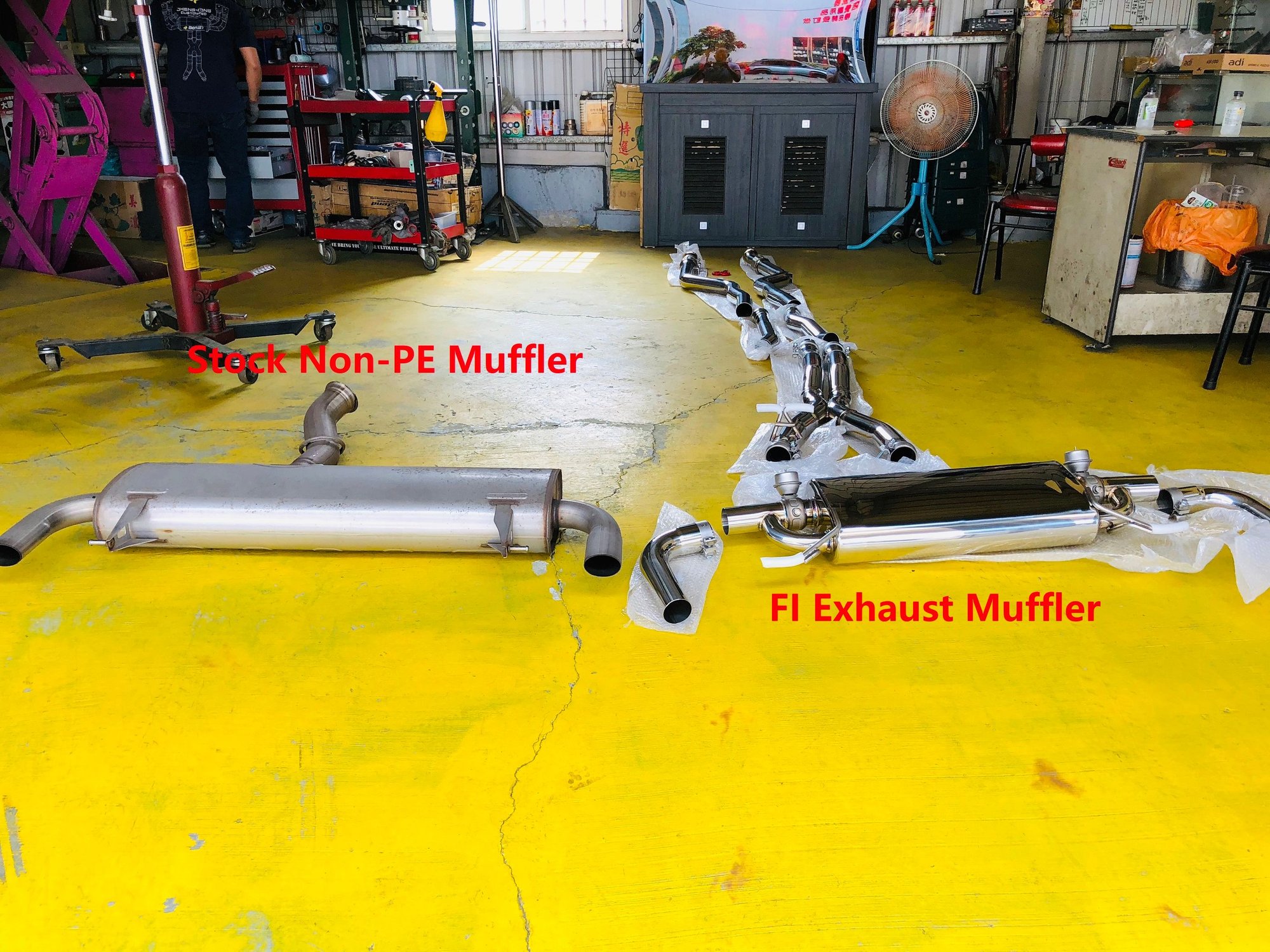

Problem:
My car has a FI Exhaust (midpipes and muffler) and the coldstart is very loud and very very unpleasant.
I had my car's Engine Electronics software updated about a month ago and my car will not stop coldstarting. It will coldstart regardless of the engine/transmission temps as long as the car has been parked for 15-20 minutes. Before the car would only cold start once a day or if the car had been parked for 4-5 hours. Now it coldstarts virtually every time I start the car
What I tried:
Benz cant/wont help me with the problem by rolling back the software update. I previously thought Eurocharged would be able to provide me a coldstart delete but that has lead to a dead end and I am pretty sure Jerry is tired of seeing my emails.
Resonator?:
I heavily considered just removing my FI Exhaust and going back to full stock exhaust, but then I realized I could just install a resonator instead.
From what I can tell, my FI Exhaust no resonator and a Valved Muffler. My original stock (non-PE) exhaust has 1 resonator and no-valves.
My questions are:
1. If I added a resonator, would my coldstart be more bearable? If there was a volume scale 1-10 (FI Exhaust: 10, AMG Non-PE Exhaust: 5) would adding a resonator atleast reduce the 10 to a 7?
2. Would my exhaust on WOT still be more aggressive than my non-PE stock exhaust? Comparable to the PE maybe? I think the PE Exhaust has 1 resonator as well right?

Old Oct 28, 2019 | 03:13 AM
waisoserious's Avatar
Joined: Feb 2016
Posts: 697
Likes: 104
From: Taiwan
GLC43, X P100D, S P100D, CT200H
So I thought I might let you guys know I installed the resonators.
Result:
- On the Coldstart noise scale 1-10, if my FI Exhaust pre-resonated was a 10 and stock Non-PE was a 5, my resonated FI is now a 8.
- WOT the car doesnt rasp anymore, which is actually unfortunate cause i really really really loved the rasp. In terms of loudness the car is almost as loud. With the valves open of course
- Regular driving with valves closed is quieter, but who cares, it was quiet with valves closed already
Conclusion:
If there is anything that I learned from this whole fiasco its that:
1. Unless you think the car has a serious serious serious problem, do NOT allow the dealership to even TOUCH your software. Ever
2. Unless you know for sure that the problem you have is directly addressed by the software update, do NOT allow the dealership to update your car
3. Even if the dealership says it addresses the problem, let somebody else do the update 1st.
4. Do not ever do a software update because you are hoping it might make your car perform better/smoother. The car is not a Windows XP PC and you should not update it as such just because there is an update available.
The resonator install cost me about $400 USD here in Taiwan including the cost of the resonators. Would I do it again? No. After hearing the results I would just go back to stock and sell my FI Exhaust. I think this would have been my course of action if I could re-do it.
But of course If I could re-do all of it, I would just never goto the dealership in the 1st place.
