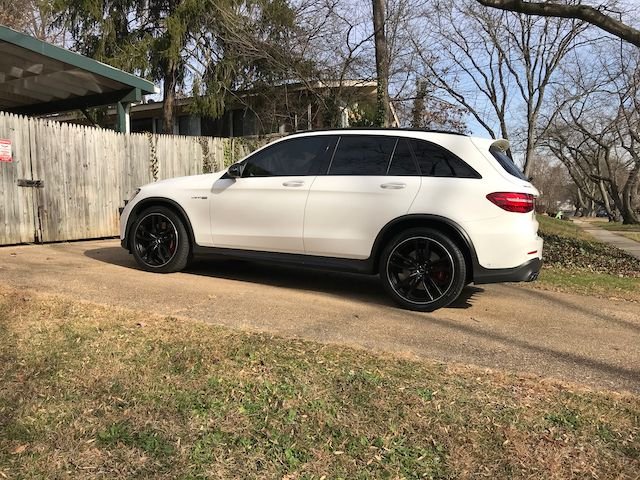

pics please of your car with rayno s5, thank you

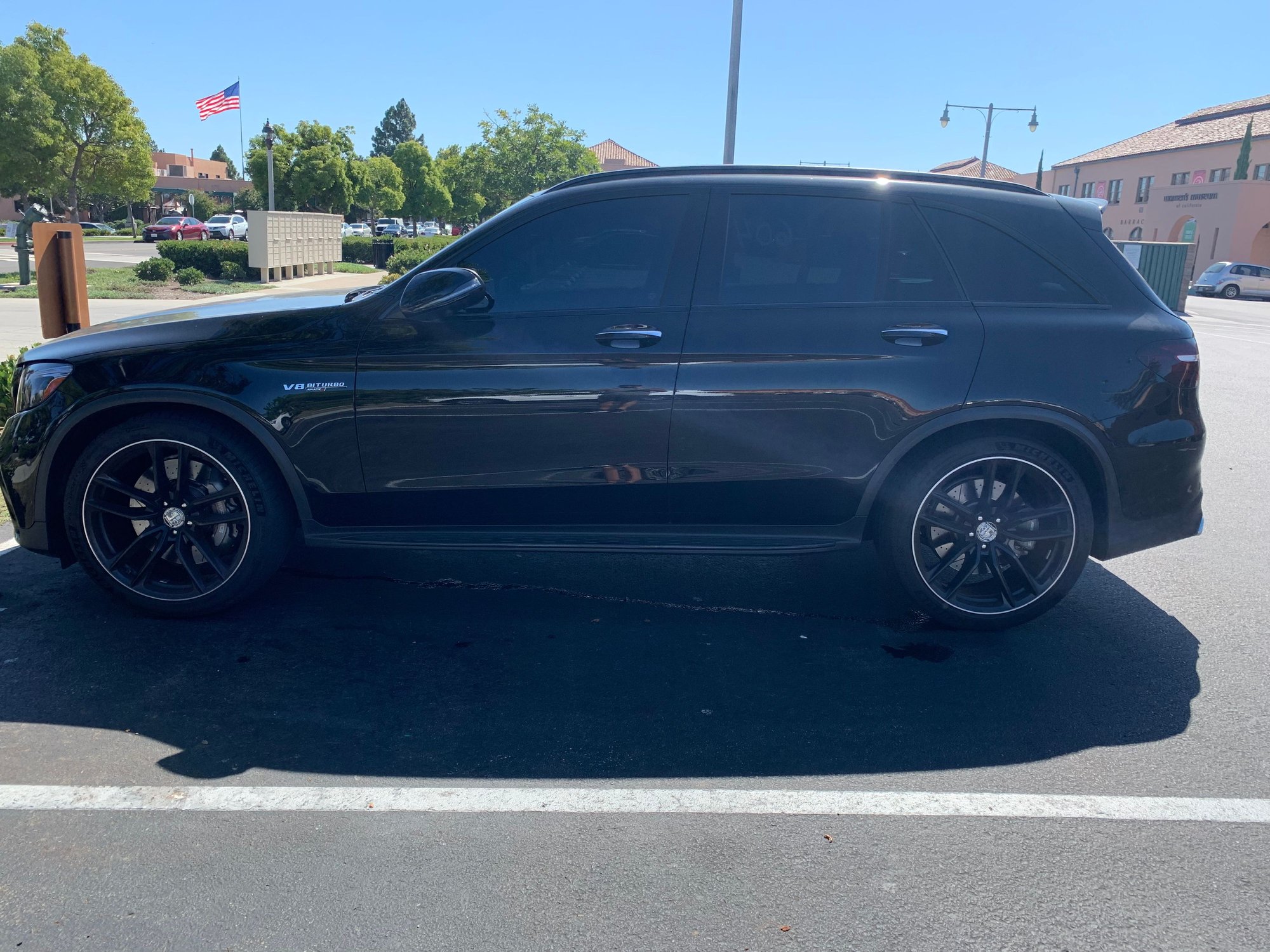

Not the best pictures.. I wasn't going for style here.....
But you can see from the inside the colors are almost identical. The sun is on the left 3rd of the B Pillar so the front looks a little "lighter" at the top.
From the outside... almost identical.
HTH's

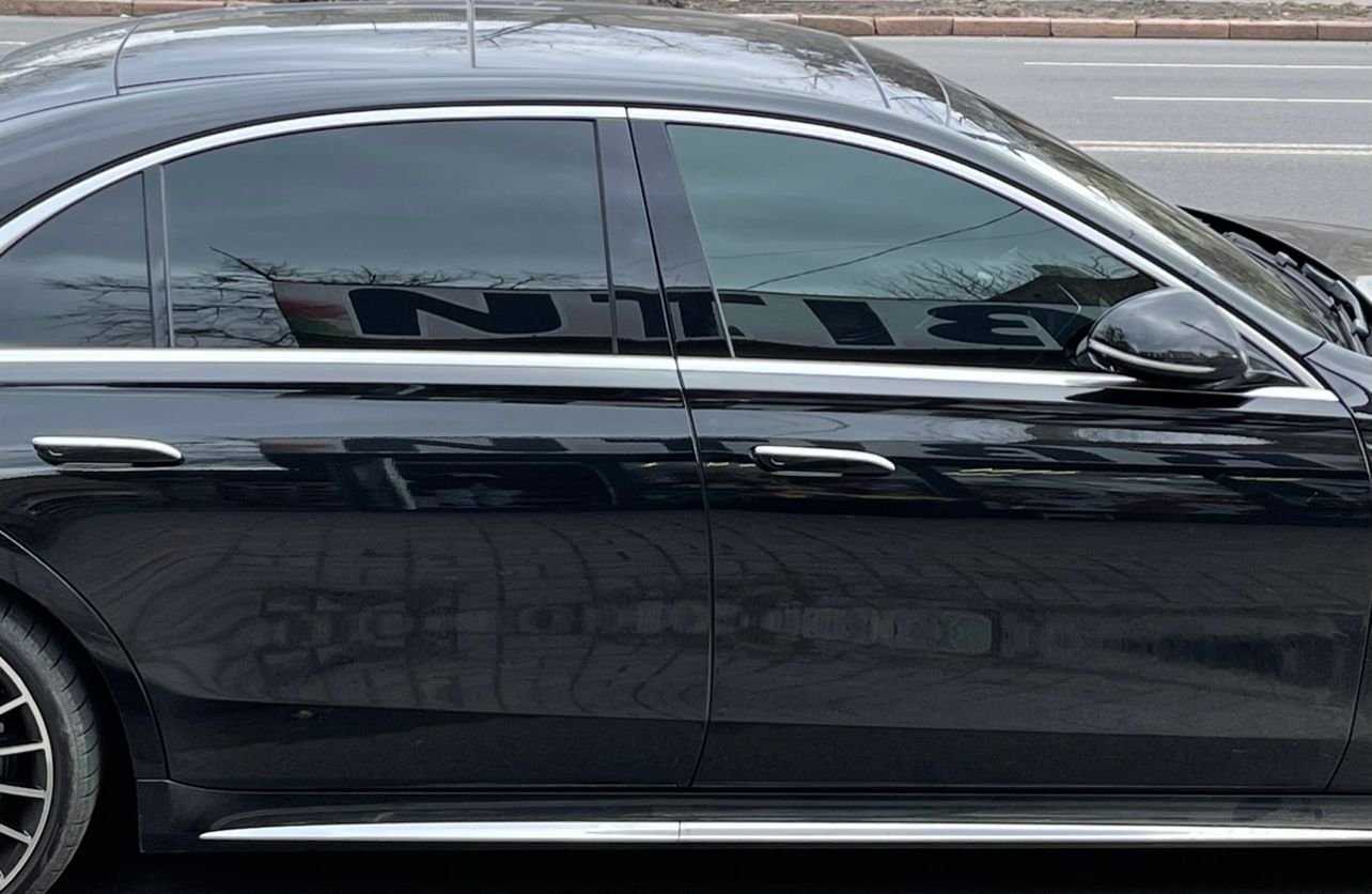

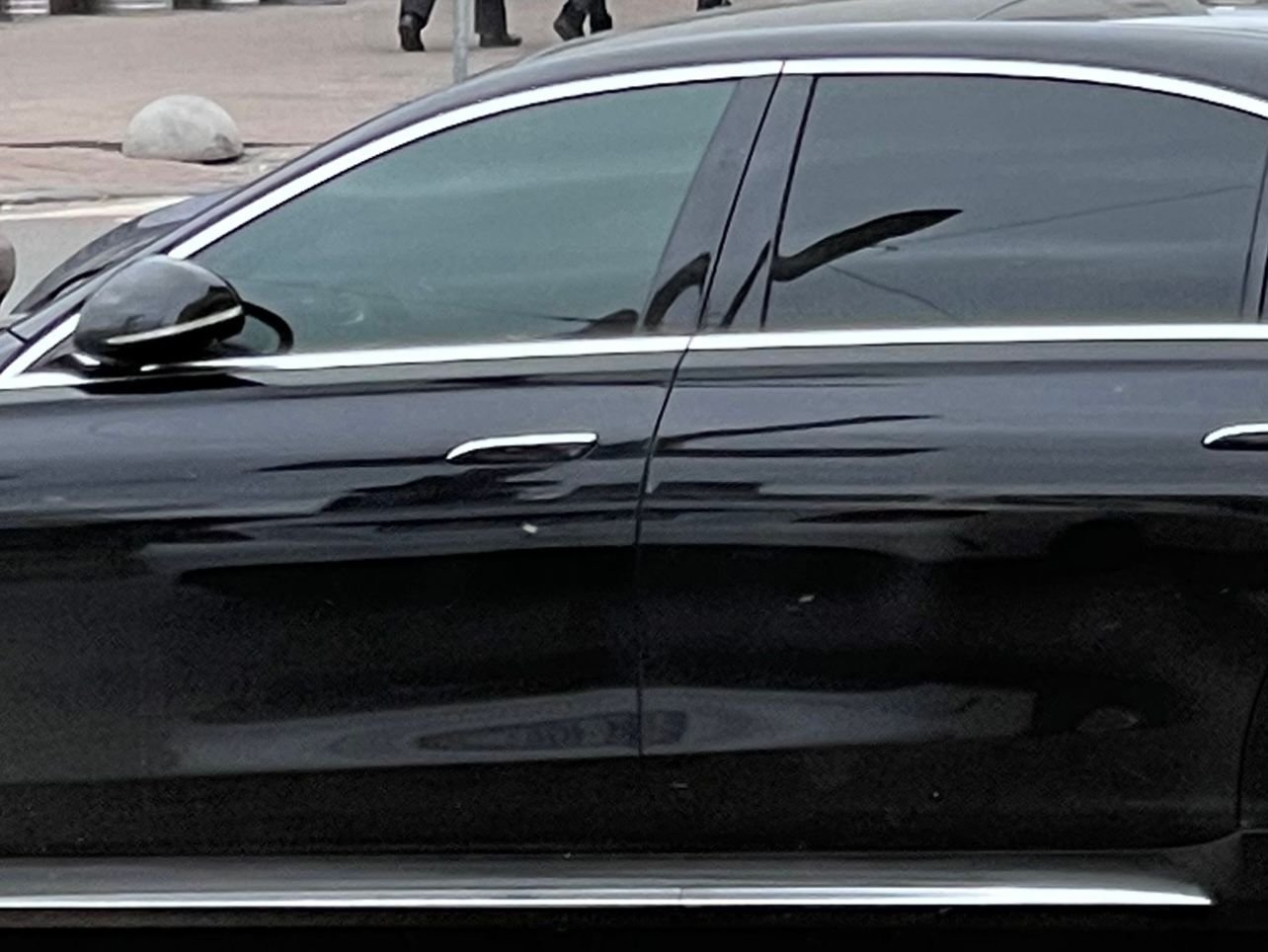

I have new w223 and tried to tint by suntec and color from outside is completely different. Any suggestions which brand of film to try?

I did XPEL 15% and it's a good match

XPEL has the closest match to factory with most vehicles. it's more expensive then all others but from what i've seen my guys install on clients cars, it's been the closest to match.
others have brown / blue and green slight tint to them.

So, I just did this dance myself. I'm a 3M or Suntek guy and have always put the high perforce versions on my cars.
The new 3M stuff is way way off. I had him install it and then take it off. Suntek was also way off.
I took the advice from my normal guy and went to look at the Rayno guy.
Unfortunately the Rayno S5 is their trash tint, but it's soooooooo freaking close to perfect both inside and out that I bet even those who are looking for a difference will have a hard time seeing it.
It's as close as I think we are likely to find.
