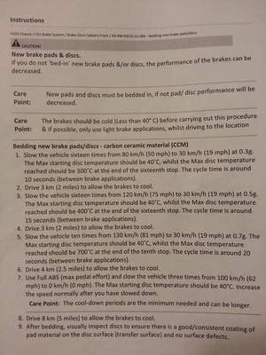

Has Mercedes Benz published a recommended bedding in procedure for their Carbon Ceramic brakes. My dealer was not aware of it, otherwise I'll rely on YouTube.

https://f80.bimmerpost.com/forums/at...1&d=1407037092

Thanks 18bora for your detailed info and your quick response.
