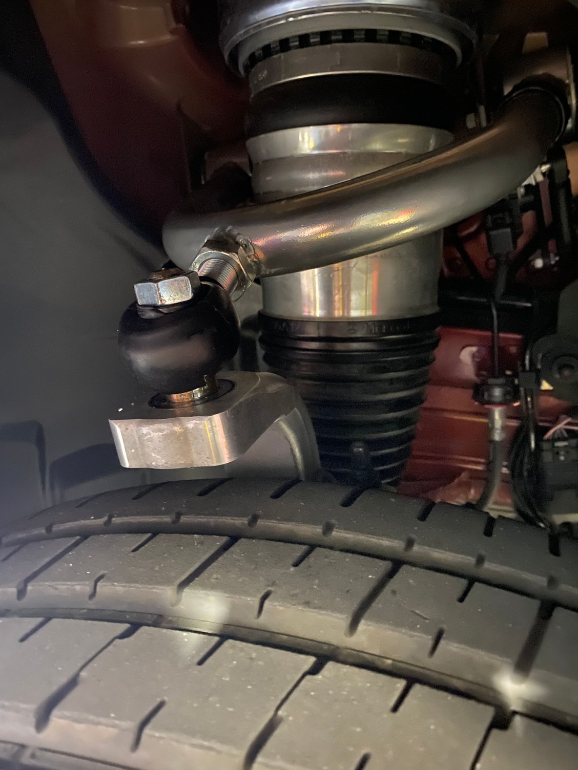

Proper camber adjustment the right way
So many guys lower their cars without doing a proper alignment to insure proper handling and even tire wear.
The thing is even stock ride height will create uneven tire wear due to the lack of camber adjustment [it is what it is].
I'm installing a set of The Camber King adjustable upper control arms today. I have these installed on my lowered AMG E 63s wagon and they work great..
I have mine setup with stock OEM rubber bushings rather than the squeaky urethane bushings...

I've had a set on my lowered wagon for the last 15,000 mi. with a camber setting of -1.6, tire wear is perfect..
Settings won't change with miles..

Front camber is now -1.4 with me in the drivers seat in Sport+ down from -2.2

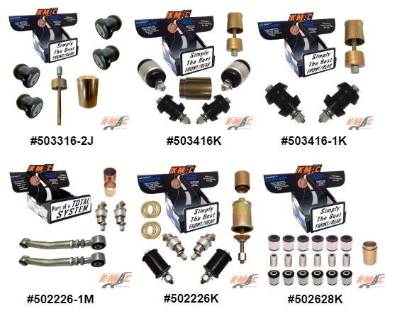

For all GLC C43, 63S models do point out we manufacture a “TOTAL SYSTEM” when it comes to resolving the situation that there is only Front and Rear Toe directional adjustment OEM !
No Front Camber or Caster and no Rear Camber to adjust tire contact angles, spread load more evenly to resolve costly, premature edge wear.
It is all to do with the ever increasing speed of new car assembly lines.
At K-MAC we have the experience of being the longest established Camber and Caster kit manufacturers constantly designing developing, improving solutions..
SEE SPOILER RE LATEST Design Breakthroughs For The C43, 63S models (ALL Kits are for both sides):
