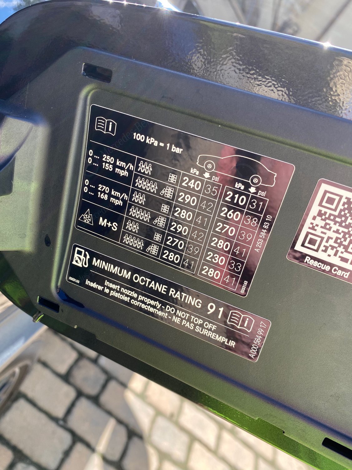

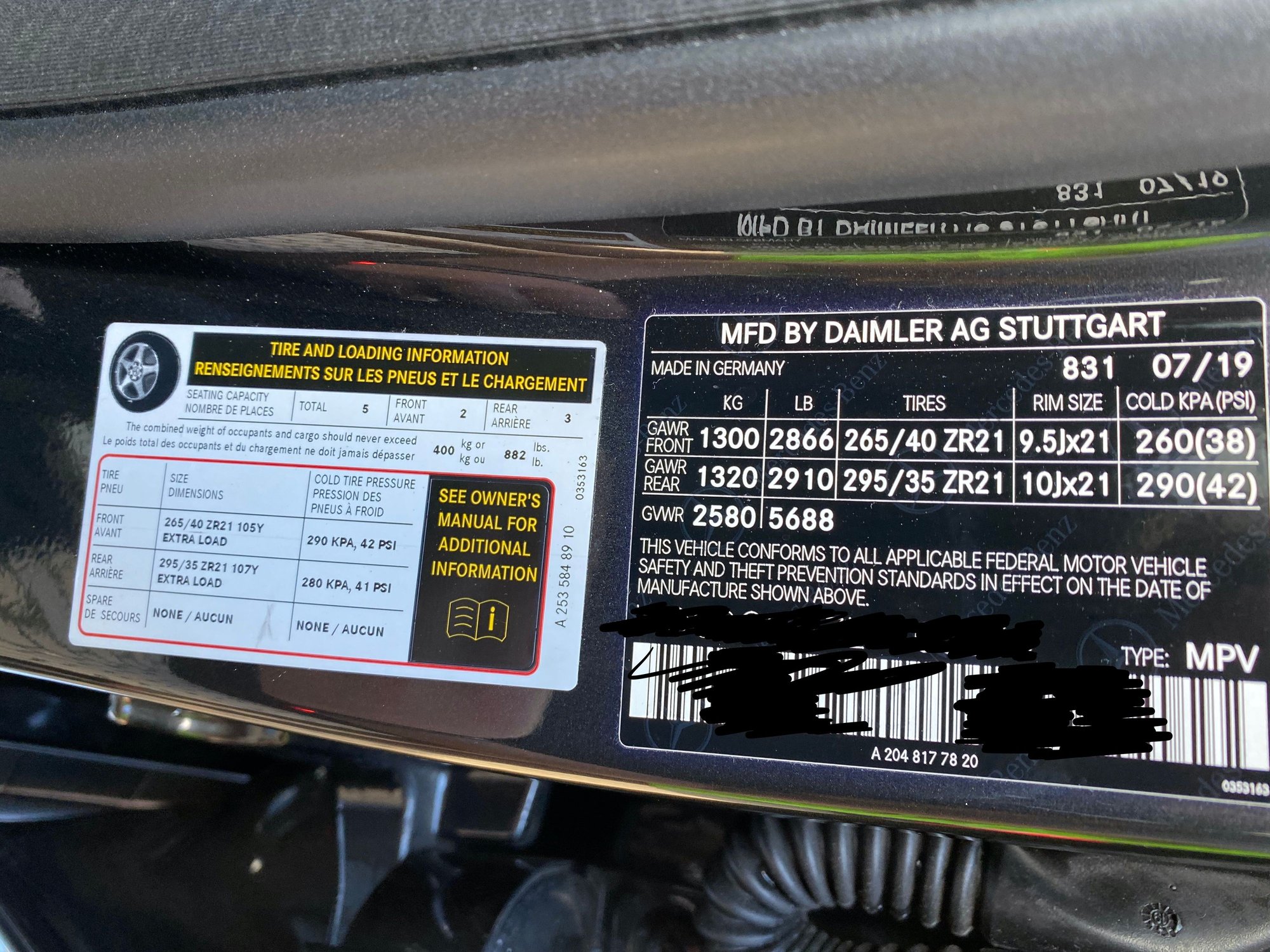

Trying to get some clarity on the correct tire pressure for my 2020 GLC63..
Dealer always fills them to 39/40 on all four corners, ride seems harsher than it needs to be at those pressures.
I see conflicting information when searching about which pressure stickers to follow, one of the two in the door jam or the one behind the gas cap.. I've attached photos of all three.

On my fuel flap the recommendation is 32 PSI all around (except when car is fully loaded). If I were to run my tyres at that pressure, the outside edges would wear ludicrously fast.

Gas Cap is the master to follow. I adjust from there. I am different tires on my GLC43, so numbers probably not relevant. I tested 0-60 on different pressures and chose the pressure that gave me the best time / bite.

I was also told by an MB service manager that the gas cap label is the one to follow. I ultimately decided to use the three-person, 168 mph recommendation (41-39) instead of the 155 mph equivalent (35-31). The 35-31 recommendation is so much lower than the other choices that I am worried about excessive tire wear.
