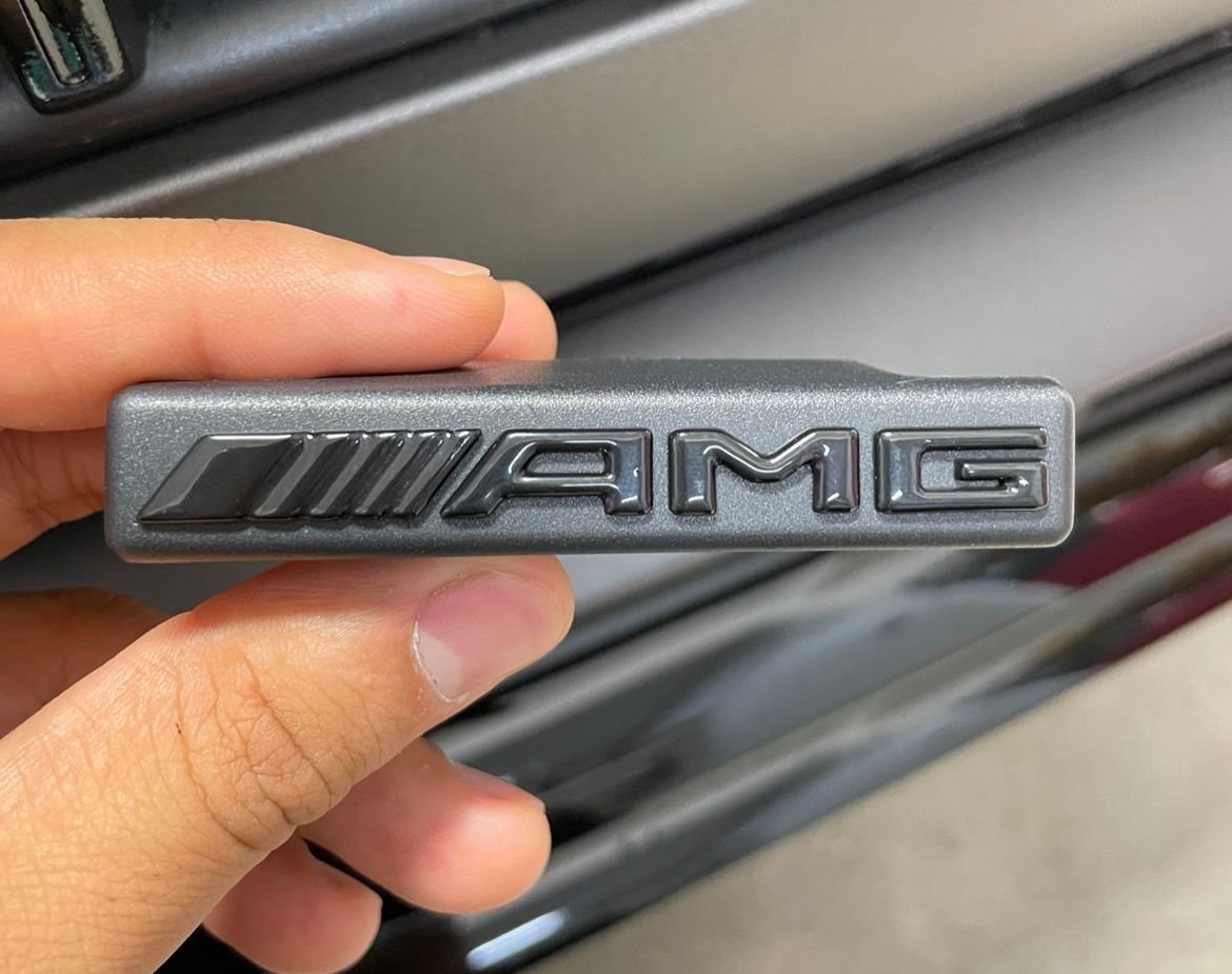

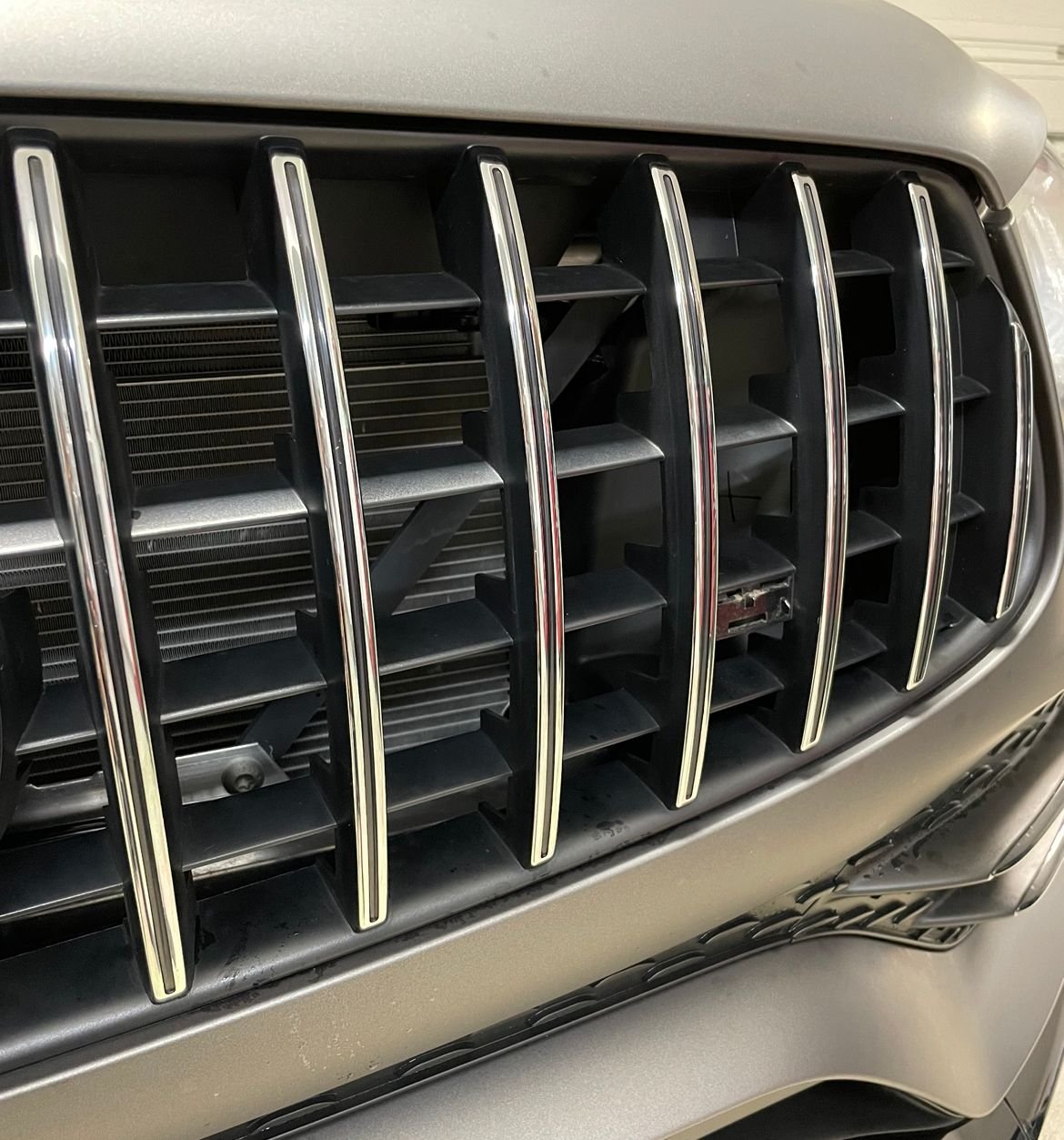

Decided to do a front end chrome delete on the panamericana grill and front emblem around the radar
Before

Well done........how is it done?

thanks, i first sanded it down, taped off the rest of the grill i only sprayed the front flat bar parts.. the rest was masked off..
2k adhesion promoter
2k gloss black
