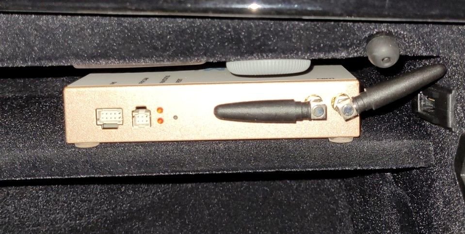

I have the IMI-1000 installed in my E350 W212. I located it in the glove box under the air conditioning vent. See Photo
While it is working it is an amazing upgrade. I say while it is working because I needed a replacement due to issues when it got hot as it will if not installed in a well ventilated location.
Presently I'm waiting for a resolution to a CanBus issue. The cursor control stops working after restarting the engine and needs a full reset to bring it back to life.
The joystick function is not affected but is limited in its functionality.
IMI-1000 installed in glove box
