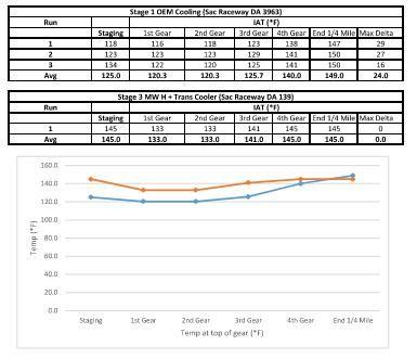

Now on to the IATs since that was what this system was designed for, lower IATs. Again, due to crappy weather lately I haven't been able to collect much data. I got one full 1/4 mile pass in November, but it's enough to compare against a few older runs on a stage 1 setup. Data is in the pics below. I know it's not apples to apples but this is the best I can provide for now, I will add more data once the weather improves. So take it easy on the comments. To sum it up, OEM Colling saw an average of a 24*F rise from staging to end of run. The MW cooling, the temps actually decrease after a couple gears then slowly climb back up to a net 0 gain in IATs throughout the run.
