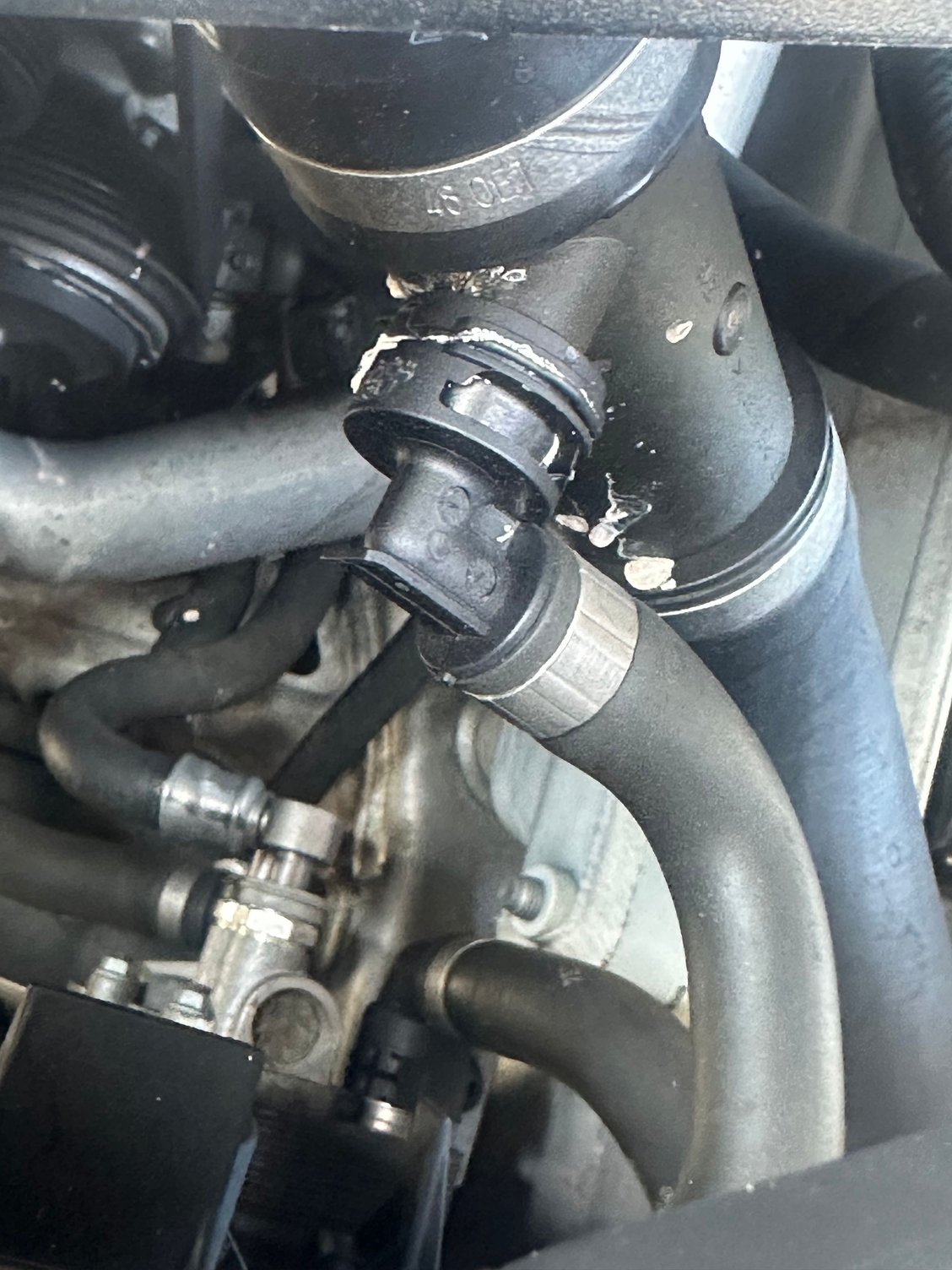

Coolant residue near upper radiator hose
Is this an acceptable amount of coolant residue on/around the upper radiator hose? Or is this a leak and the hose needs to be replaced immediately?
No, but I would cool everything off and pull that connection off and clean inside and out. Check the rubber seal inside and make sure the clip is secured once back on. Cleaning and reseating the seal may do it. If it still leaks after that, time for a new one.
