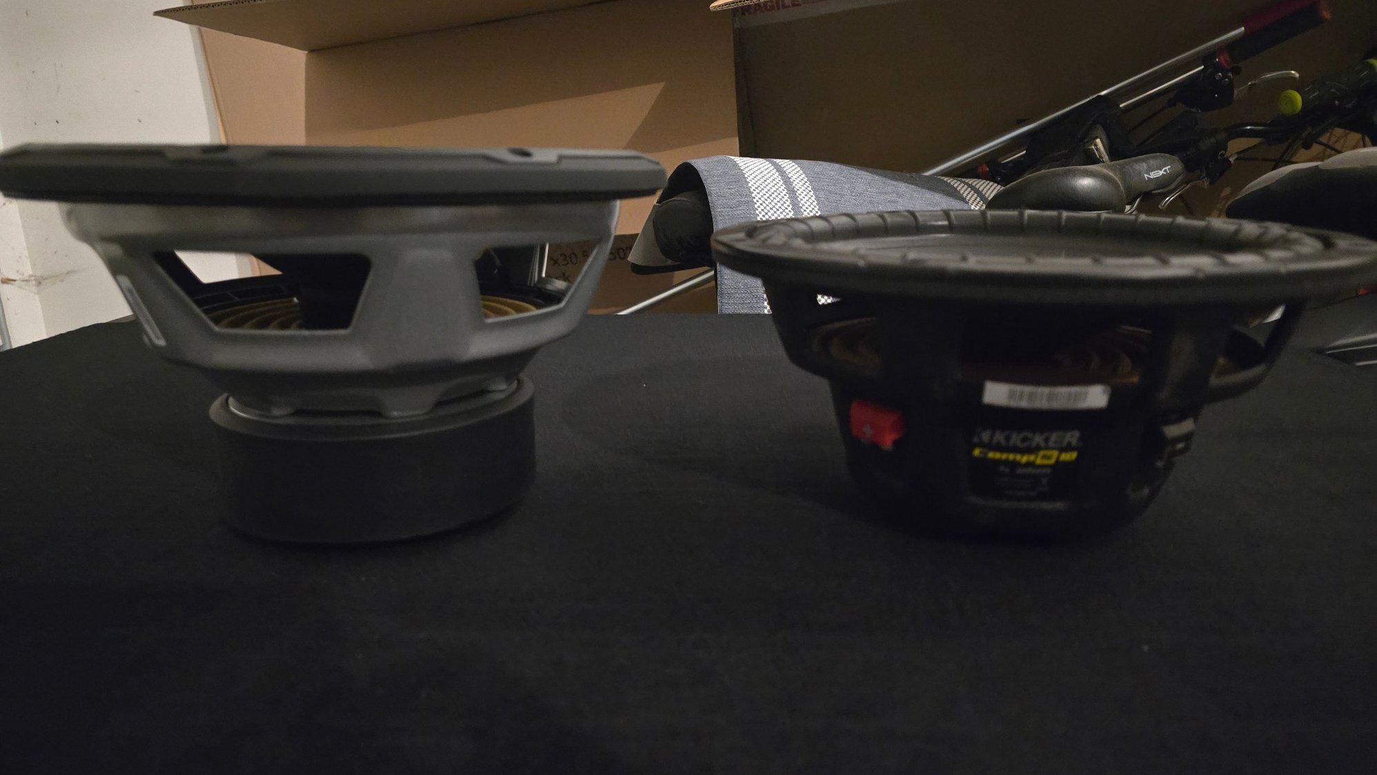

Installed a subwoofer with a my old JL Amp from 25 years ago. Modified the wedge box to a square box fits perfectly in trunk. It sounds better than the Burmester I heard from a loaner. Make sure to tap into front speakers unless you want your exhaust sound pumped to the subwoofer.

The bottom cover was rattling when I turn the volume up, I have a WeatherTech liner on top of it so that fixed it. I don't hear any rattles so far from driver seat even at almost full volume. su woofer is only 2 to 3 inches from the cover.

Upgraded to JL 10W3v3-2
Sounds even better with solid bass hits.
