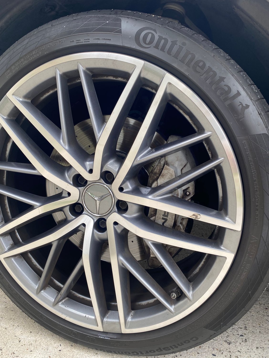

I didn’t see an existing thread about this. I have a 2020 GLC Coupe and am trying to find out the best way to clean the grease and grime from the front brake calipers. Does anyone have any experience about how to do this? I have tried soapy water on a soft toothbrush, Meguiar’s Ultimate brake dust cleaner, and Simple Green 50/50 diluted with water. These helped a little bit, but the calipers are still dirty. Thanks in advance for any feedback.

CRC Brakleen is intended for cleaning brake components. There are several other brands and many formulations. Available at auto stores and even Walmart. Work in a well ventilated area and wear rubber gloves and eye protection. Brake cleaner solvents evaporate, but a catch tray will keep the grime from staining your driveway/floor.
