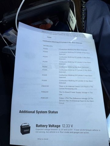

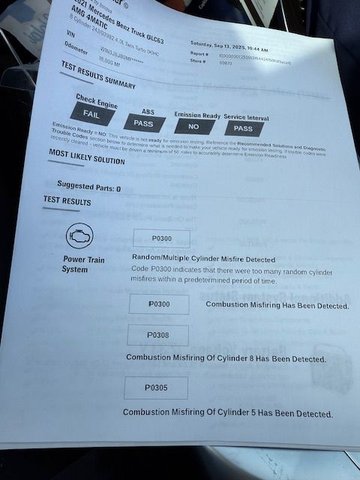

We took the GLC on a road trip from Phoenix to Vail, CO. As we are leaving Durango and heading on our last leg to Phoenix, we started the car and got 'Coolant Level Low'. NAPA was next to the hotel. Got some approved coolant of the right spec. My wife filled it up while I was doing other things and off we go. We get about 5 miles out of town and the coolant light is back. Turns out she didn't put the cap back on. Fortunately it wasn't lost. Filled it back up. Put cap on and off we go. CEL comes on and it starts running rough. I suggest we go back. Stop at Autozone and they can scan it.
It looks like multiple misfires, but there is a CPU fault and a low power supply. Oh, by the way...... the coolant is low again. I'm thinking that the low battery may be causing the misfires, but there is also a coolant leak. Are there any common coolant leak locations. It's Saturday 9/13. There are no MB dealers here and the 2 shops that say the do Mercs are closed. If anyone is local and has some suggestions or has a place we can take it to as all my tools and lift are at home, I would appreciate any help. Send a PM if you can help. Thanks. Attached are the scans from AutoZone.

After the Autozone codes (cleared up after everything dried), the truck transport debacle that never worked out (I think the Russians have taken over that biz and they suck and are a bunch of criminals.) and the lack of any shops...... I fixed it in the hotel parking lot.
I could see no leaks and there was never a puddle under the car. I thought that maybe when the cap was off that maybe a lot of fluid was lost from the cap being off and it sucked in some air in the system. We bought 2 gallon of coolant and gradually added coolant, ran the car, watched the bubbles come out......level would drop. Add more coolant... repeat. After doing this 4X, level stayed up and temp was stable.
Car is fine. Drove back to Phoenix without incident. I still can't believe it puked almost 2 gallons of coolant.
