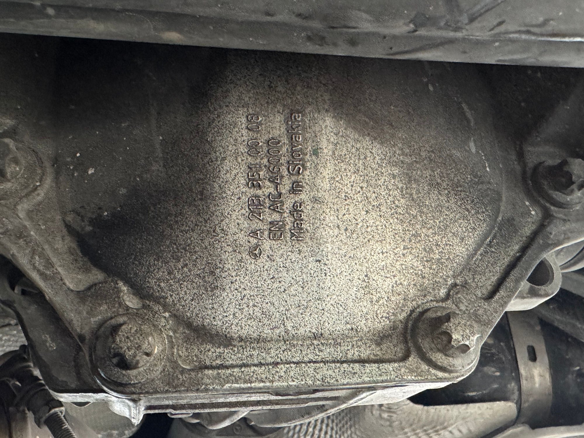

Leveled the vehicle with a water spirit level at the running board and drained the rear differential fluid after 30min of cool down. Pumped in one quart of Red Line 75W90 fluid; probably spilled a little using a 500cc syringe yet none of the fluid overflowed from the fill port.
Diff case marking was A213 351 00 08
Had to get another bottle the next day and fill approximately 130ml to get the diff oil starts overflowing.
YouTube videos I watched had the diff oil overflowing within the 1 quart of fluid. Anyone had similar experiences not overflowing with 1 quart of fluid?
