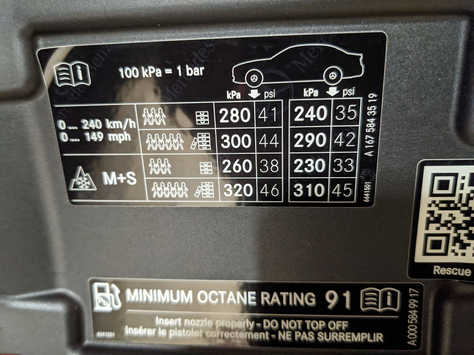

That’s the pressure for Highway tires...don’t you have AS’s?
AS Conti tires are M&S rated see the sidewall. 38/33 or 46/45.

I am not a fan of M+S "ratings" on tires, so I thought I'd air down from the 45/45 that the car was delivered with, to the next step down, which is <blank> pressure of 41/35 (top line on gas flap). (It's easier to air down than fire up the compressor to air up, so I took the easy way to see what it felt like, to adjust later.)
To digress, M+S is not a "rating" or performance attainment - it's just an advertising "claim." The Three Peaks Mountain Snowflake (3PMSF) is an actual performance rating. At least in the USA.
The Conti's are marked M+S, but they don't qualify for the 3PMSF, so I used the NON-3PMSF pressures. (My rationale FWIW.)
Also, the OE Conti's are marked MO-1, which means that the tires are developed for AMG cars - "Mercedes Original 1- Made specifically for AMG, MO1 tires have a rubber mixture and carcass structure that match the vehicle’s suspension." https://www.mbusa.com/en/owners/part...original-tires
