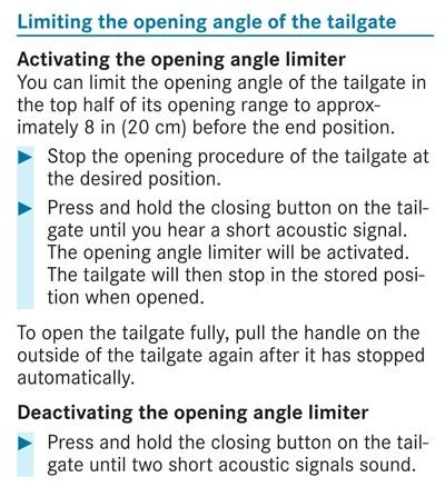

3. Can you adjust the height of the opening of the rear door. At 5'10" I find it quite a reach to hit the close button. This vehicle is noticeably larger than her 2016;

3. Stop the hatch at the height you like and hold the close button down until you hear beeps. Then test to see if it worked.

3. What Ron.s says is correct (when in doubt read your manual, though I know some stuff is hard to find):
