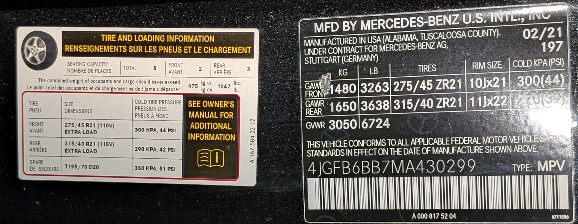

At the scales, I was 200 lbs over my Cargo Capacity but still had about 250 - 300lbs to spare at each axle.

1st pic is our 2020 GLE450 doorpost sticker with axle capacities
