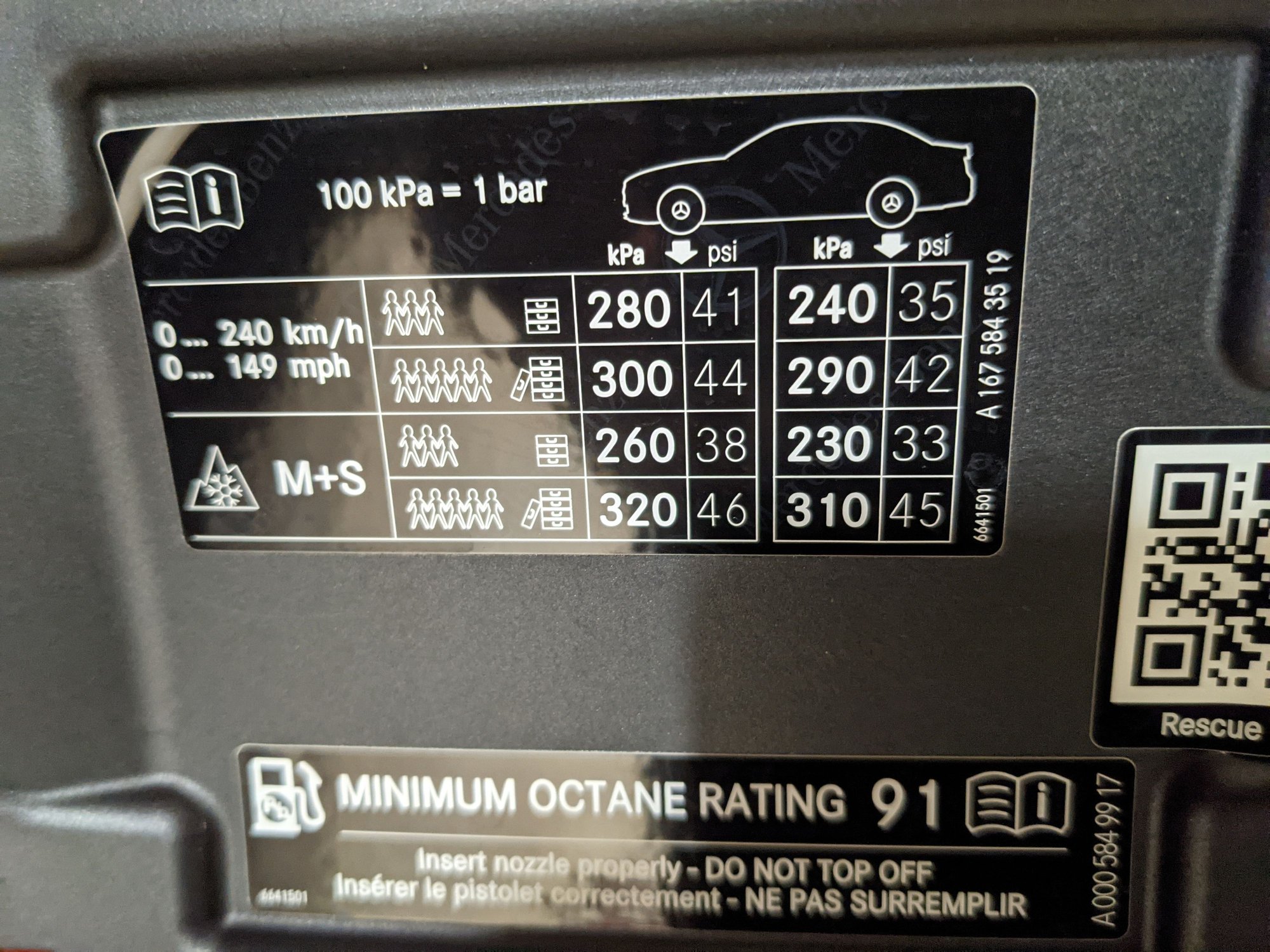

It looks like you have those pressures reversed? It is counterintuitive that the front would be higher when loaded and unlike other GLE models (see my fuel filler sticker below). I run 32F/33R normally, raising the rear when more loaded.
That’s why I reduced the front pressure thinking they might have them reversed. Here’s mine for the 53 with M&S is the third line down with 3 passengers.

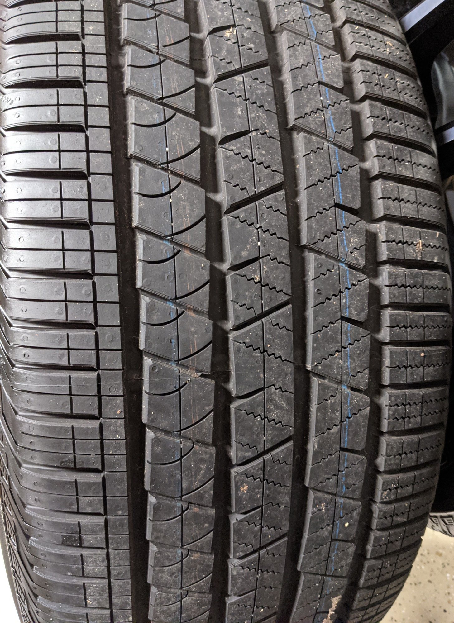

I’m not a Conti fan anyway but it’s currently the only V rated tire in the GLE 53 AS sizes. There are several Michelin and Pirelli in H rated. I might have something else going on with the suspension so it might not be the tires. I prefer a firm Sporty ride but also don’t like getting my teeth chattering on bumps.

Snow performance seems good with the Conti’s and the tread pattern looks to be new compared to a set I saw a year or two ago. The inside and outer tread are different much like a set of tires I ran on my RZR 2 years ago. These have siping on the inside. I was in the Blizzard Friday that is now in Colorado....heavy wet snow that packed and became greasy and slicker than ice. Temps were just below freezing so the rubber compound might be better than your standard AS. The I 15 freeway closed for 5 hours just after I made it through. There was heavy traffic and slower speeds of 20-50mph but the tires seemed to work well stopping and accelerating. It would take more experience at higher speeds and colder temps to know for certain but so far nothing negative. I’ll be in St George until the end of the month so this will probably be the end of winter driving conditions for this season. Here’s a pic of the tread-

I don’t have a strong recommendation for tire pressure other than maybe to drop the front tires to 35 from the 38 recommendation for 3 passengers. That would be 35F-33R. Any less and we probably risk uneven tread wear from under inflation.
