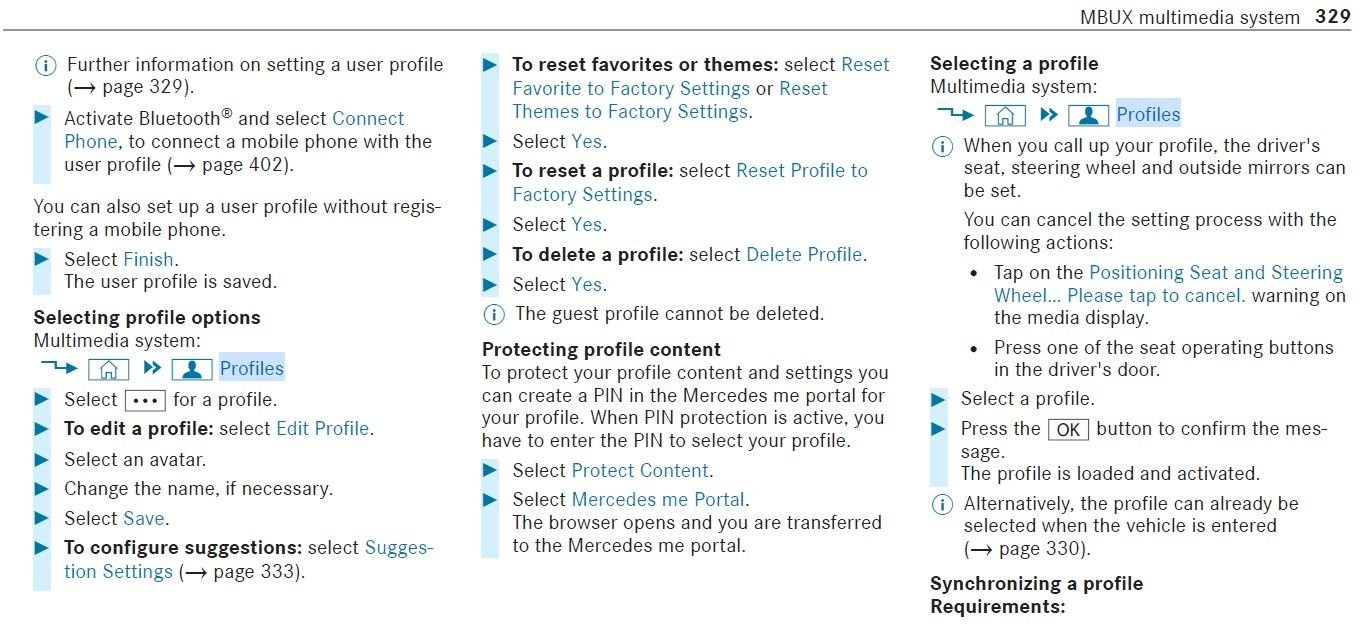

That said, The HUD is tied to the memory buttons, and also to the profile selection. However using profiles will control more functions. Here's the pertinent info out of the GLE manual:
Memory Button Details:
Profile Setting Details:
