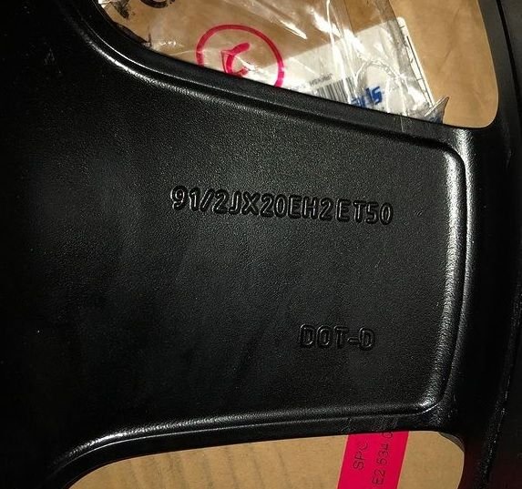

Hi all,
A wheel question.... A tire shop is giving me a deal for a set of OEM G63 W463 wheels. Black with silver lips. (I'm going for the night package look)
The specs are R20x9,5 ET 50.
The shop claims the wheels were taken off a 2016 G63 who's owner upgraded to aftermarket.
Right now, I have the OEM AMG 20" wheels from dealership.
Tire on Pirelli Scorpion 275/50 R20.
Anyone knows whether the tires can be a direct replacement?

Gwagon wheels (130PCD 84CB) will not fit any other (112PCD 66.5CB) Mercedes.

Bolt pattern(PCD) was addressed above while bolts' size (14x1.5 vs. 15x1.25) is fixable as Greg did by enlarging bolt holes. And while CB is also easily addressable with centering rings, PCD is a big issue.

Thank you both for the answer ... very helpful before I bought the wheels which would become useless (unless I buy a G63).
I would have thought MB would use the same PCD on all their SUVs ... make it easier for upgraders.
