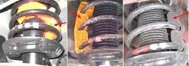

On occasion dealerships forget to remove the shipping blocks from the suspension during PDI. These prevent suspension movement while the car is transported and must be removed before delivery, but sometimes get left behind. They come in different shapes and colors, but if you look at the springs they are plastic pieces that keep the springs from compressing. Below are a couple of examples. Happens more often than it should.

I would second its likely one or both of the above causing it. GLE's are far from stiff.

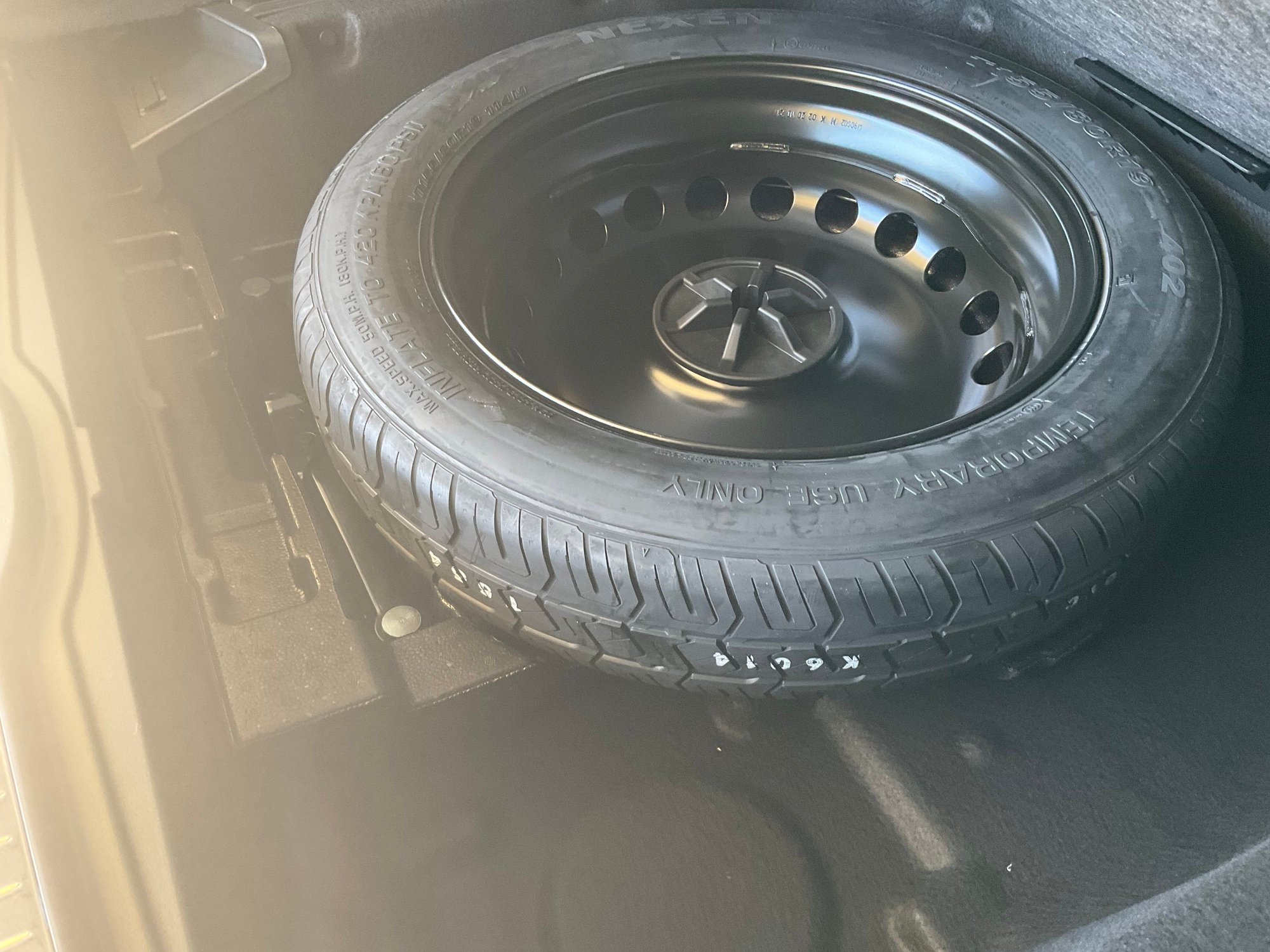

I would complain to your sales person and GSM. Fair to assume that your GLE would not have the dreaded run flats. Almost all of the 2022s are coming without run flats. I’d insist on a change out. And separately, despite many of you disagreeing with me here….try to always go with the standard size (19”) on the GLE. Larger sizes often have less suspension travel and occasionally hit the upper wall of each wheel space when encountering road bumps.
Standard 19” Michelins
Standard spare tire with non run flats
