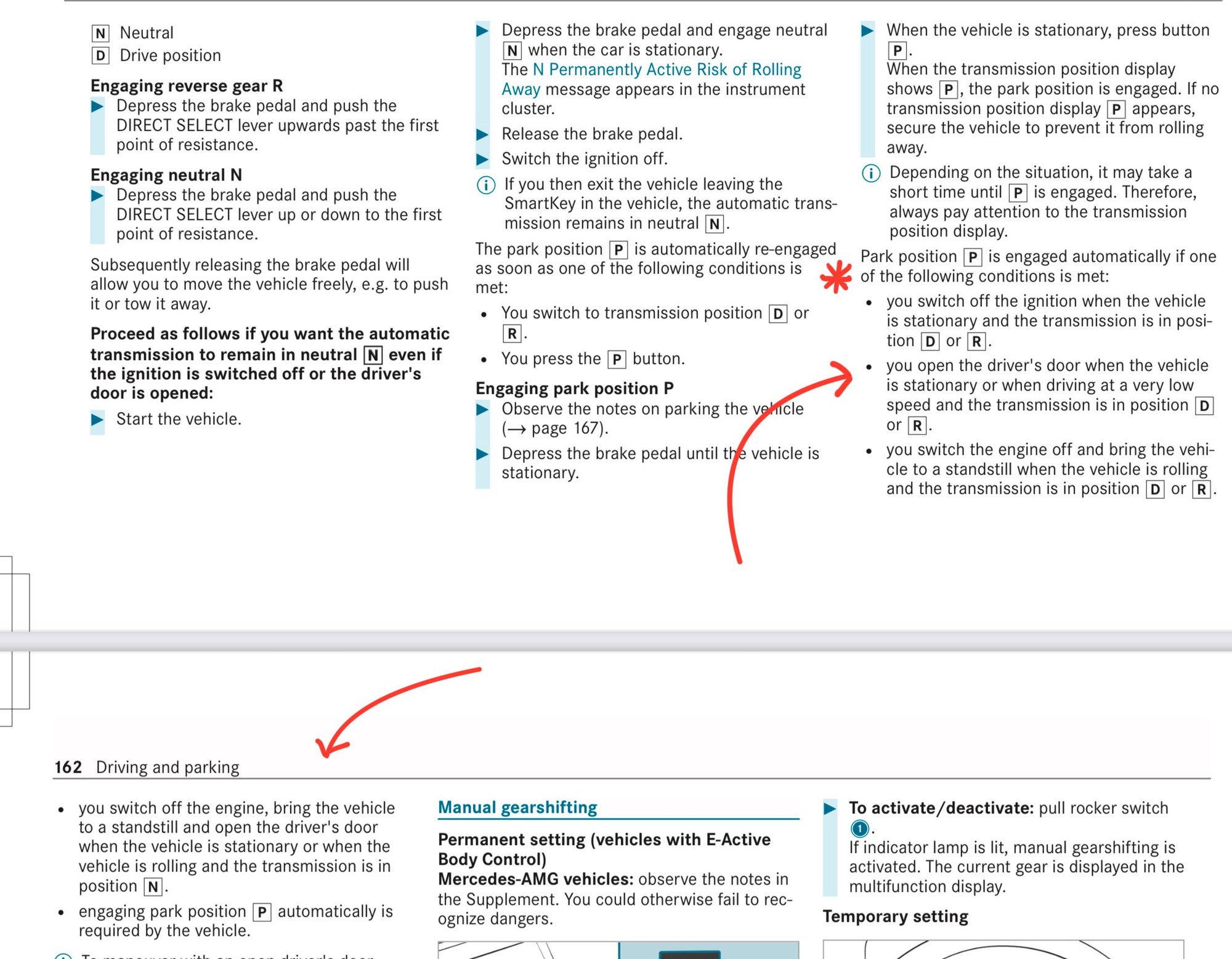

Originally Posted by Elvisfan0108
A lot of cars automatically go into park if you open the door.
Originally Posted by GregW / Oregon
The GLE does that/
Under which scenario would this happen or you want it to happen? Driving and someone opens a door? Lol. Or your foot is on the brake and someone opens?
Old Jun 25, 2022 | 09:21 AM
Neurobit's Avatar
Joined: Sep 2015
Posts: 526
Likes: 203
From: Texas
2021 GLE 53 AMG Coupe
